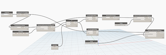

So here’s where I’m at with Sean’s graph that I used as a model:
I have a type parameter within my walls called “Base Partition Type”. Each wall type has a nomenclature (for sake of argument, let’s say A10, B20, C30, etc.). So when you go into the wall type properties, under the wall type parameter, you will see similar text.
Also under the wall type properties, every wall type has a type parameter called “Fire Rating (Dynamo Type)”.
The doors have an instance parameter simply called “Fire Rating”.

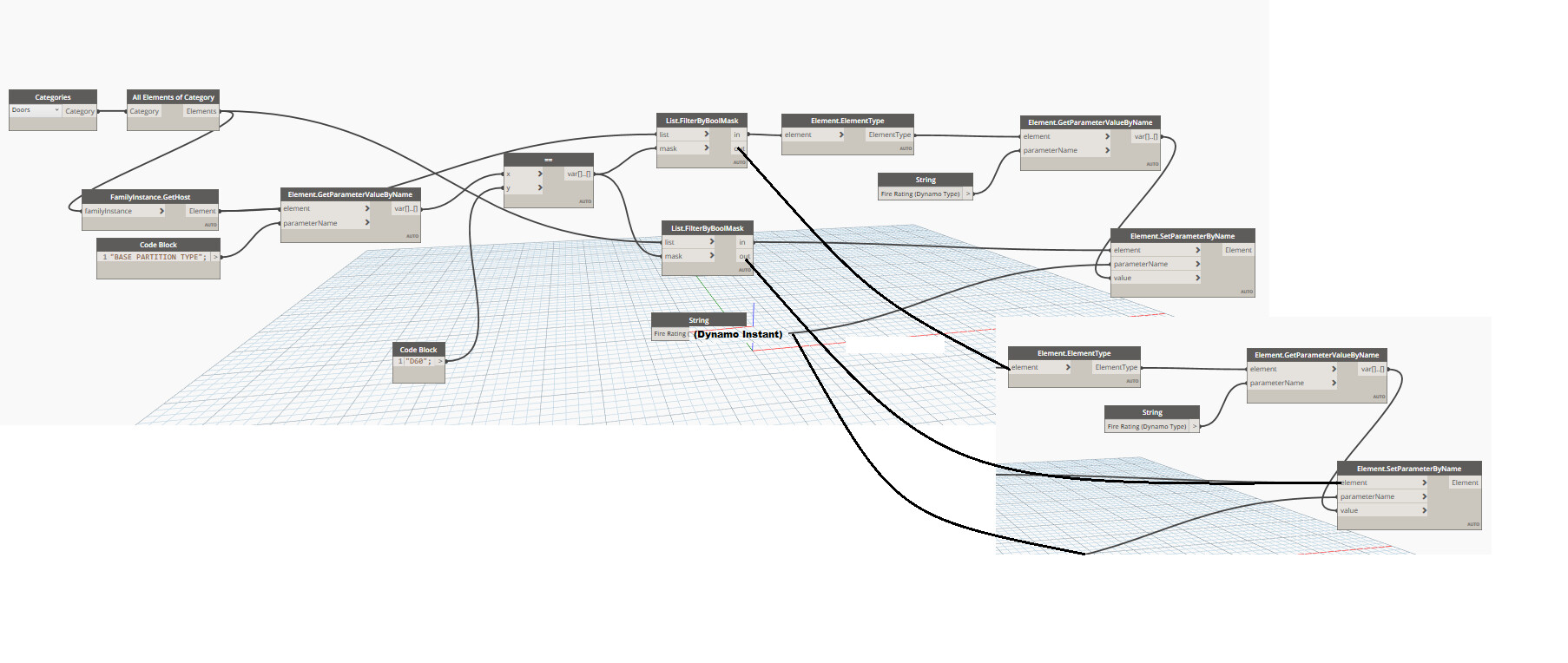

Not sure what I am doing wrong, but now the fire ratings aren’t showing up at all in the schedule:
I ultimately want all the doors except wall type A28 to be reduced by 0.75. Doors in type A28 walls will be 20 minute doors in a 1-hour wall.
Ideas? Thanks!

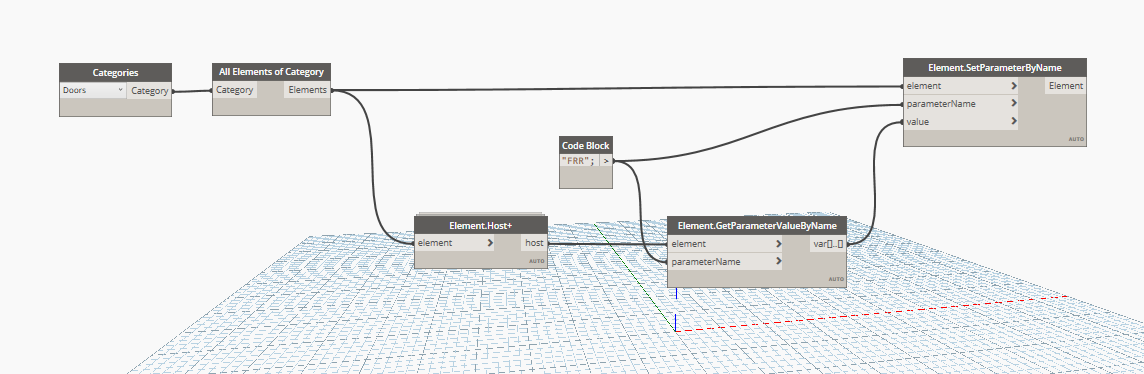

Try this, the host node is from clockwork.
As Sean said, according to your own text you used Fire Rating (Dynamo Type) at the bottom of your script where you should use Fire Rating.
That this doubles up on the Fire Rating parameter (your new one and the default one) is also probably why you’re having troubles.

@augustinpe

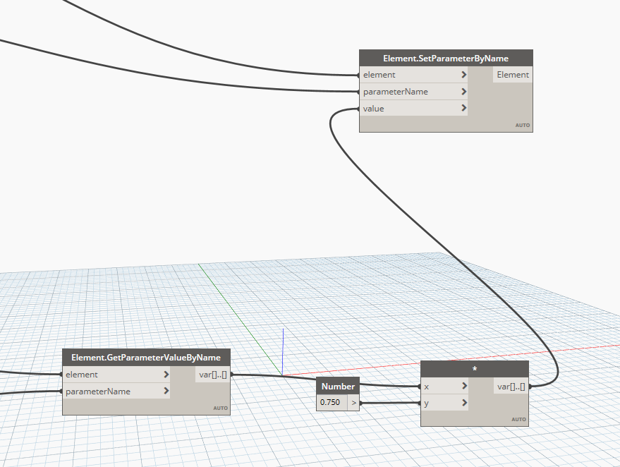

The GetParameter should have a Type Parameter like in your Graph - Fire Rating (Type Parameter). The SetParameter should get a Instant Parameter in example - Fire Rating (Instant Parameter).
Keep in mind :point_down: (try to avoid Parameters with the same name in your Project).
If you want to report 0.75 times the Fire Rating
to your Doors the you have to use a Math node (x * y) after the GetParameter and before the SetParameter.
You need to duplicate / split part of the nodes.
A part to set Doors 0.75 of the FR and a part to set Doors 1/3 of the FR.
Maybe this :point_down: helps?

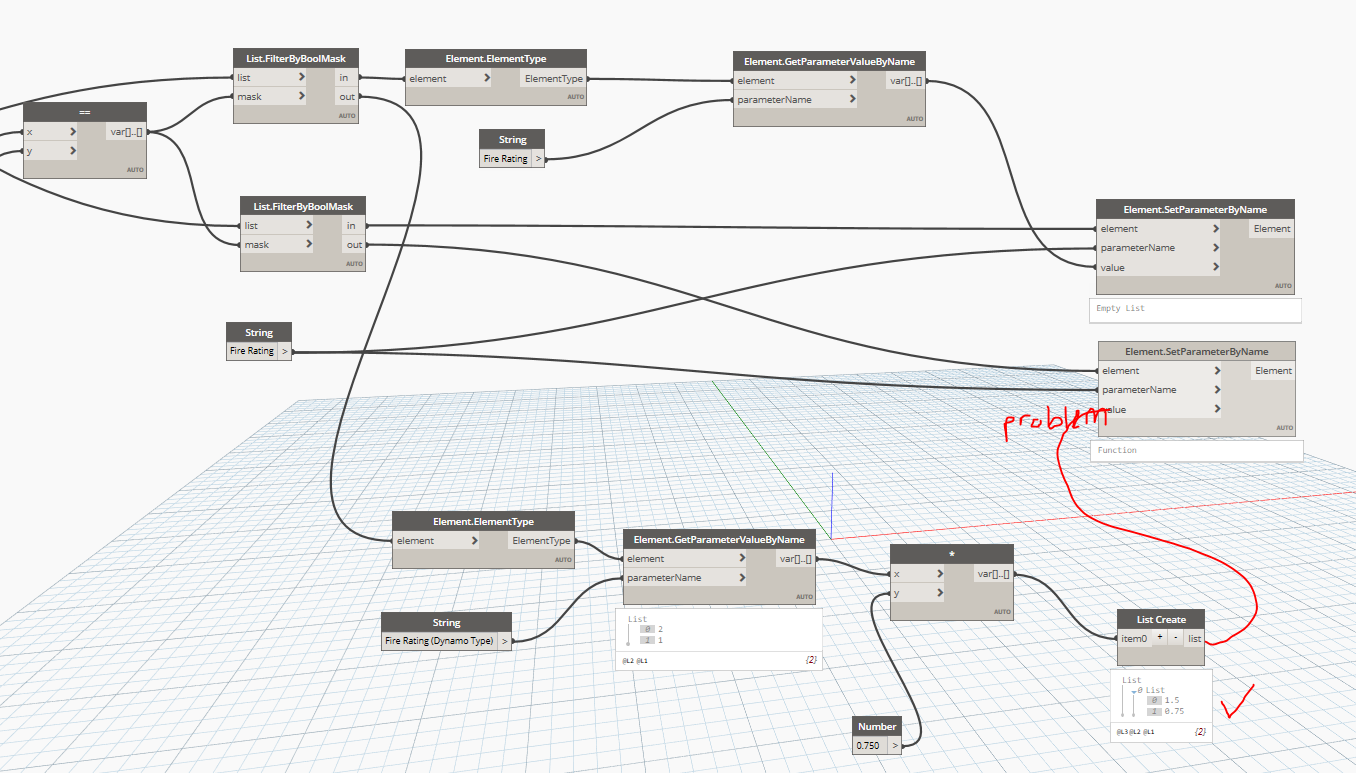

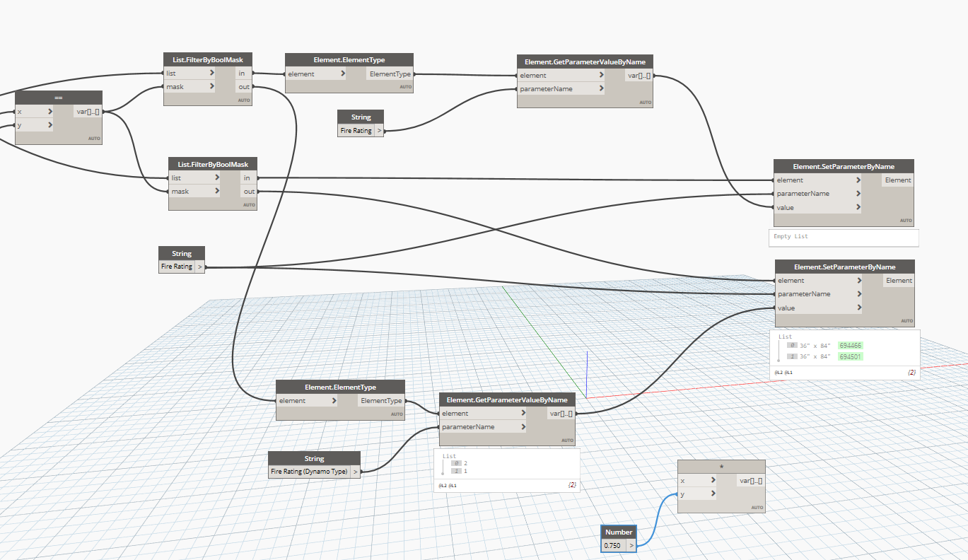

BVS - thank you so much! That worked! My only issue now is that when I hook up the multiplication node with a number 0.75 for example (and I tried all variations), the FR is not changing. Wierd.
My two hour FR is changing to a 1-hour and a one hour FR is changing to 0…
It is hard to tell why without seeing the whole
Graph and it’s values (you can pin then Lists / white boxes under the nodes)
Are their any warnings?
The 2 and 1 values are showing up correctly in the schedule… its only when I hook up the number and * node that I get incorrect values.
I need to see the values of the calculation node wired.
Wild guess… might be a rounding issue. What kinda parameters are your FR parameters?
Are they a Text, Integer or Number?
