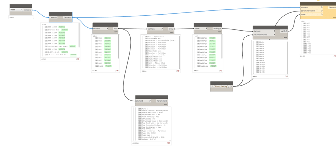

Having difficulty in getting my doors to pull the fire rating from the walls they are hosted in. this looked easy, but guess I’m missing something.
Any advice would be greatly received!

Or you could replace WallType.Name and WallType.ByName with Clockwork’s Element.Type node.
thanks John and Andreas!
Hi Johan / Andreas,
S0 I’ve tried both versions and they do pick up the Fire Rating from the Walls (If I create a new Instance Parameter called Fire Rating)
I can see to work it so that it picks up on the existing Type parameter that walls and doors already have.
Also it isn’t pushing the wall rating back onto the door for some reason (no errors are displayed)
Any ideas?
Many thanks
Ok sussed - I have the final set parameter element coming from the wall node and not the door - it was obscured by other nodes - guess thats why its good to use teh cleanup node layout function…
still working on the issue of getting and pushing back to the type parameter though - guessing I have a node which is designed to look at the instance in my string
Good afternoon ! I was trying to accomplish the same result but I get this warning, help much appreciate it Thanks!
Hello again I’m following up with the last post,I’ve been trying to find out and follow exactly as John did on his example because I have to do basically the same , assign the Fire rating from the wall host to the door.
I get a message that says [Element.SetParameterByName operation failed. No parameter found by that name] Even though my Fire Rating parameter does exist on both Wall and Door. Please note that I have not created any additional project parameters, I’m using the ones by default in the families under identity data. Maybe I should create a Type or Instance parameter which I have tested but still no luck.
But basically I want to copy information from host wall to my door, any help much appreciate it!
Thanks!
maybe you can check your Fire Rating code block why it has 1 in front?
