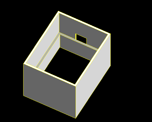

Hello everybody. I have a question. That is how to creat wall finish by room ??? I tried with more script on forum but it is work. Could you help me? I need for my work. Thanks for your help.

@D.JohnWick Make sure your having the wall type where you assigning the parameter wall name.
I just tested and it works as expected.
Good Luck!
I do like your tutorial but it dont work as expexted .Do you can send your test file ( dynamo & revit) ?
Can Show me Project parameter dialog box for Wall Name & Ceiling Height
They are instance parameters applied to wall category. One should be text based (finish type), the other length based (ceiling height).
