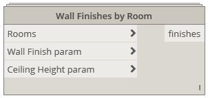

I make this for create wall finishes by rooms, using parameters: Wall Finish and Cieling Height (Archilab examples)…

Maybe this helps:
Thanks, i try that node but dosnt run in rvt 2017…
@torrez83.rt It may be a little late, but it does work on Revit 2017. Have you followed the instructions on our website MODELICAL? The parameter that reads “Ceiling height” must be a length parameter.
I hope it will be useful in future situations!
Thanks¡, indeed the node works, it was a language question between english and spanish version, the parameter names that ar manually written must be edited to spanish.
