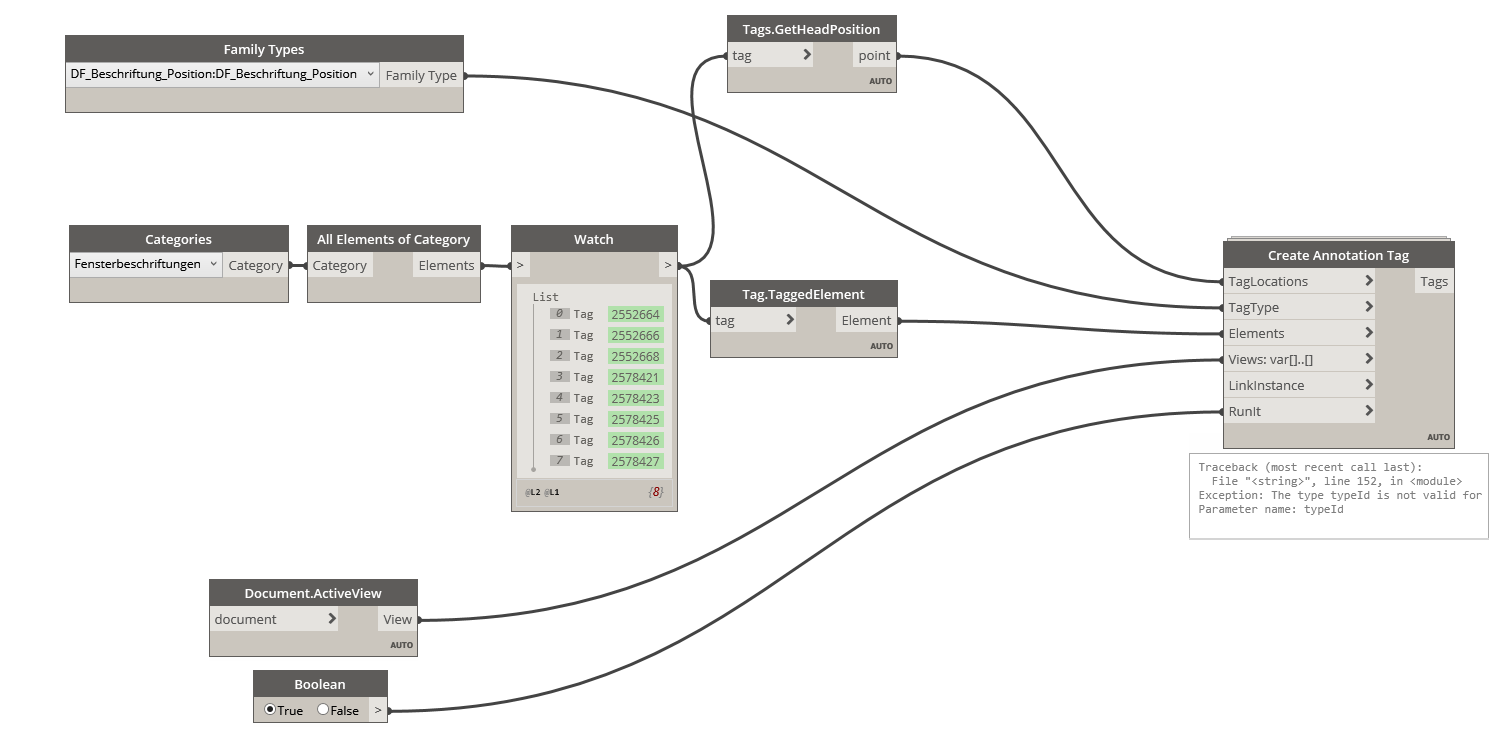

I’ve been trying to replace Windows’ Tags with Multi-Category ones with no success. I tried with the Block from Archilab (Image) as well with the one from GeniusLoci
If I use the node from GeniusLoci the error sais:
Traceback (most recent call last):
  File "<string>", line 182, in <module>
AttributeError: 'Document' object has no attribute 'NewTag'
Can someone point me in the right direction?
@alban_de_chasteigner ?

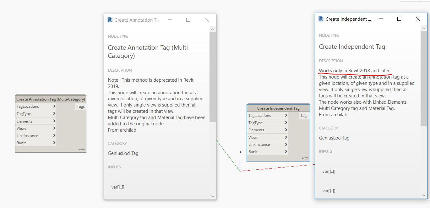

Hi @M.Perez,
You’re probably working with Revit 2019 and you need to use the Create Independent Tag node.
The Create Annotation Tag (Multi-Category) node is for Revit 2017 and previous versions.
The Create Independent Tag node can also be use to tag linked elements.

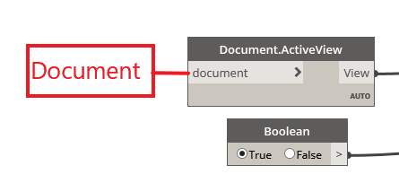

You may have also forgotten a document node.

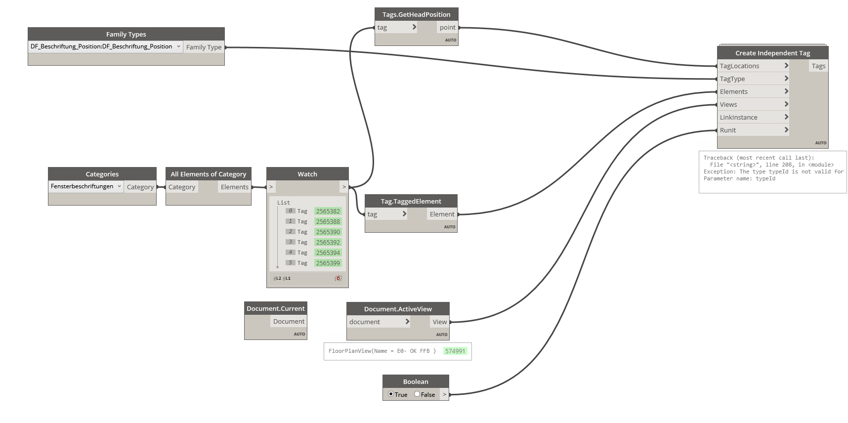

Hi @Alban_de_Chasteigner, thanks for your help again! I had read that from 2019 Create Independent Tag was the right node, but had no success either:
Independent%20Tag
Document.ActiveView seams to be working as expected (see last image, view properly identify).

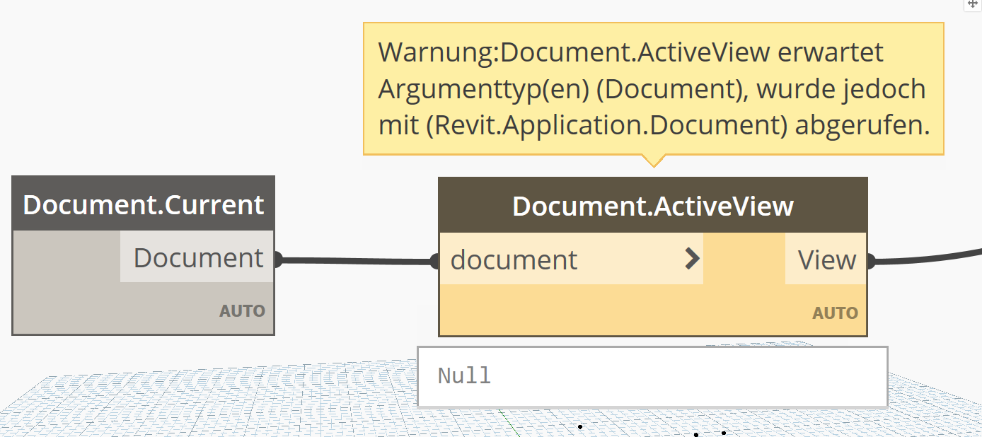

I tried to do as you say but then Document.ActiveView doesn’t work :S
Document
I am more than confused with this graph.
Can you add a sample file with the family tags and the family to tag (Windows ?) ?
If I try to use a normal Windows tag than it works, but not if a use the Multi-Category tag. In that case, just the first is replaced but with another Tag Family (a Windows’ tag)

It works perfectly on my computer.
Replace%20tags
Replace%20tags%202
If you’re using a german version of Revit, please see this post :
https://forum.dynamobim.com/t/create-annotation-tag-archilab-geniusloci-error-in-line-196/35804/4
That was it!! I hate this behavior in Dynamo :sob: I just run Revit in English, and it works… Thanks @Alban_de_Chasteigner for your dedication, I would have never find it out!!
