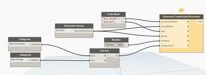

In Dynamo 1.2 how can a new Project Parameter be made using a Shared Parameter?
mhmmm, first of all please post the warning/error that you are getting. Secondly, just by looking at this, I can guess that:
  1. groupName is not a parameterGroup input type but rather a string that represents the Shared Parameter Group name. That’s a group inside of your Shared Parameter file.
  2. Type, is probably a type of parameter, ex. Text, Integer etc.
  3. is List.Join the right node here? I think List.Create would do the trick.
Again, please post more accurate information. Do you just expect people to guess what is wrong with your set-up?
Changing the Type and the Shared Parameter Group worked, thanks Konrad.
