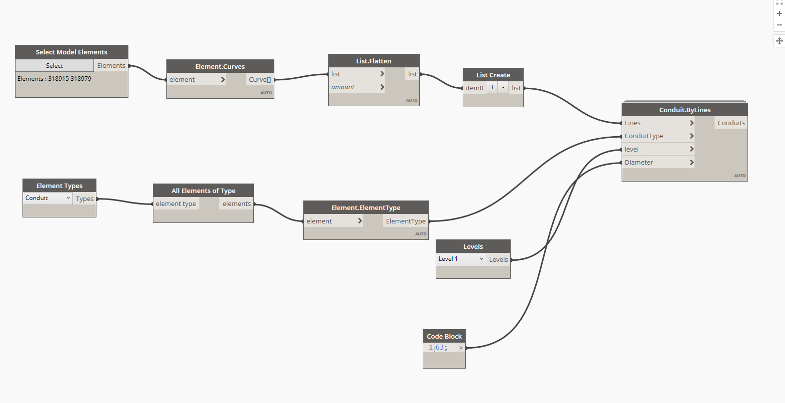

Here is a very fast example it could be a start…
hello
in mine conduit.Bylines node not shows??

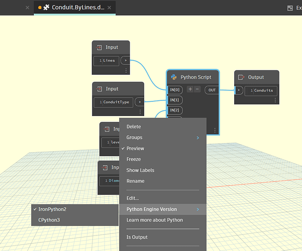

Hello Could you show an image what you try…you will need mepover package if you are in 2023 then be sure you had python 2,7 package installed, the open the dyf and set to python 2 engine and save and should work…

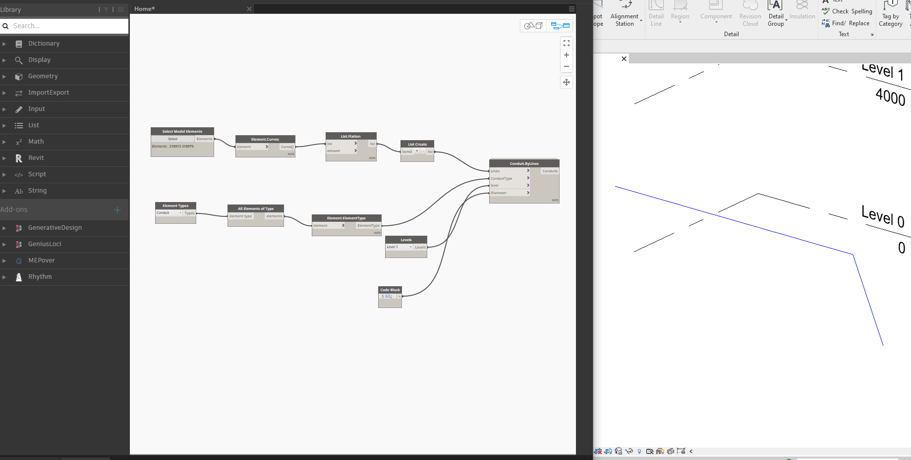

yes i did but in revit conduit not showing as output

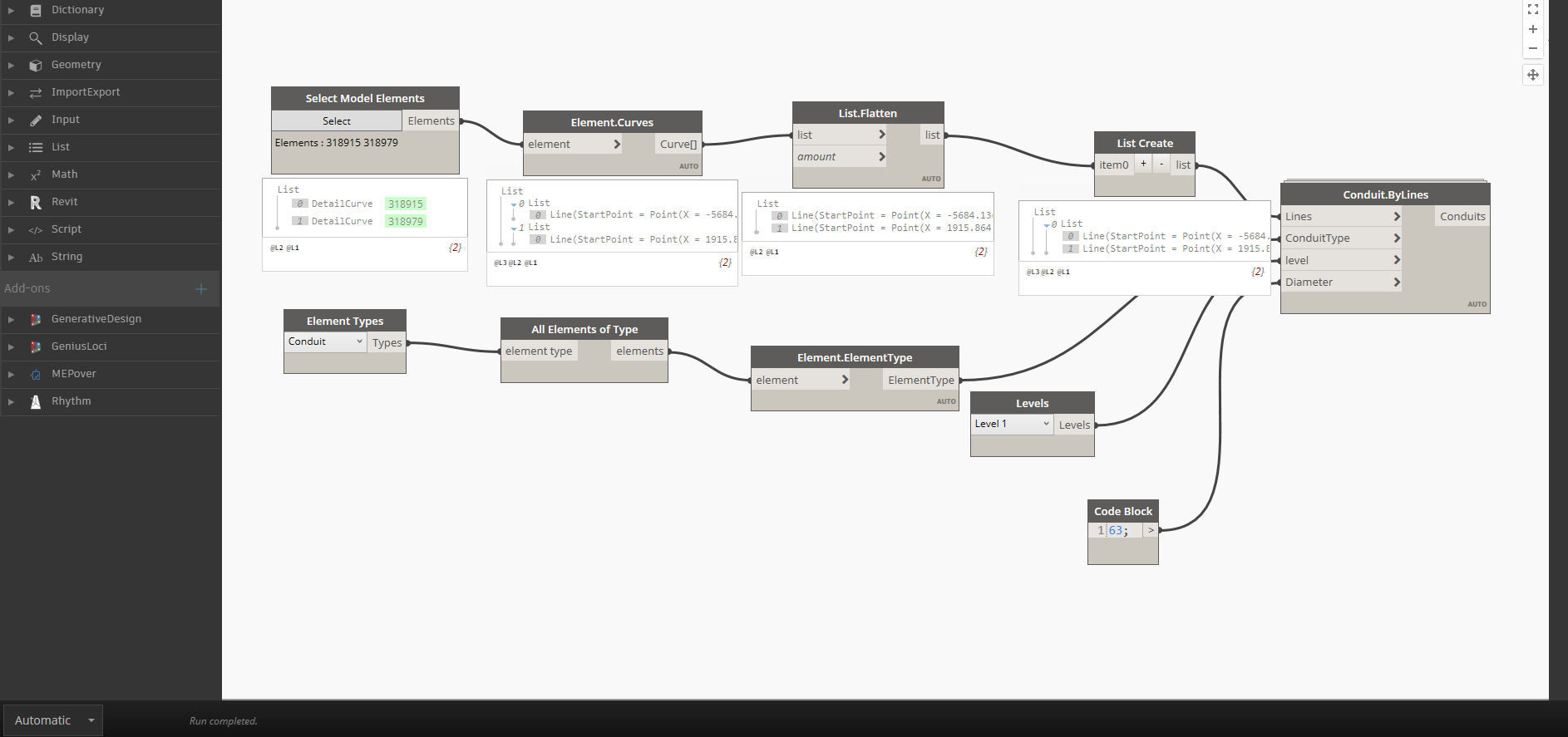

Could you show an image with all nodes expanded so we can see whats happend :wink: i dont know how many conduit type you have be sure you only feed in one type, use get at index…and try set lacing to longest in your conduit node
now is it visible
looks good so far…what does element element type gives you ? and remember lacing
conduit type
only one ?
yeah need to add more?
nope only one…have your tried lacing longest
yaa but it shows emty list
