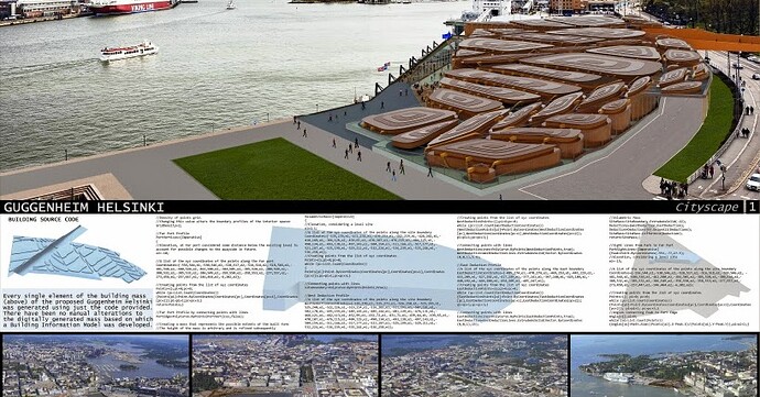

You might want to take a look at some of my reasonably successful attempts at doing so using Dynamo/Design Script (from about 2-3 years ago)

This is simply amazing!!
Can you please share how you are able to dot it?
@mrityu I won’t be able to share the code, but can tell you it’s done completely with just Design Script
