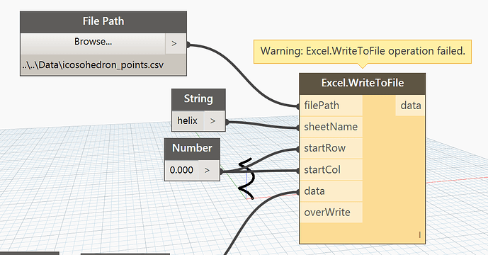

Excel Nodes Fail Dynamo 1.1.0
Been having issues with this lately, has anyone else noticed this. I swear it used to work! :neutral_face:
  • Dynamo 1.1.0
  • Revit 2016
  • Excel 2010

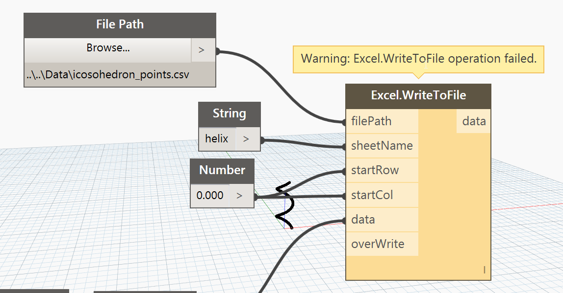

I had the same issue with Excel using revit 2015/2016, dynamo 1.0 &1.1 on Windows 10. So i started using flux.io to get around it, never thought of using a csv file. The issue looks to be with excel as when I try to write to excel, Excel opens but the flux addin tab for excel is missing and no data written. Then I manually open excel the flux tab is there for excel?? The same thing happened when I’d no flux addin installed.
Same thing happens on my colleagues machine. Excel has issues.
