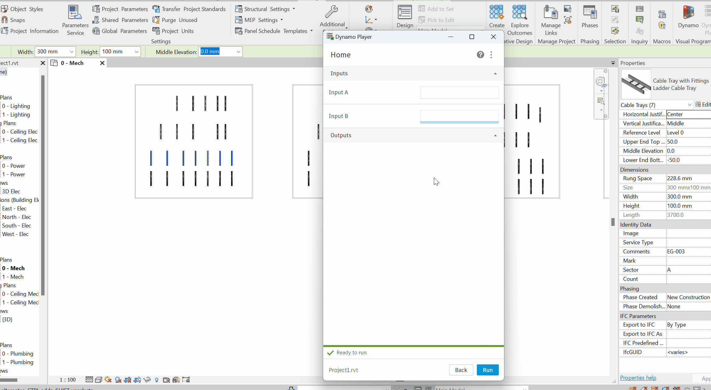

I have developed Dynamo script to count Revit element which is have two parameters and it is working fine.
Link of post :https://forum.dynamobim.com/t/filter-out-elements-by-multiple-parameters-similar-as-revit-filter/84589
To run above script I need two parameters. (Input A and Input B).
for input A i have 1 list (refer below snap Blue box) and for input B i have another list of 100 tags (Refer orange box)
Currently using below step to run script :
  1. manually entering “A_” in purple in input A (Green box)
  2. manually entering one by one “EG-0001, EG-0002,…EG-0100” in purple in input B (Green box)
  3. manually entering “B_” in purple in input A (Green box).
  4. repeating step 2.
Now I want to create script for avoid above mentioned step.
any guide on above is much appreciated.
Thanks and regards.

1st run :
Input A = A_
Input B = EG-001
2st run :
Input A = A_
Input B = EG-002
Next run :
Input A = B_
Input B = EG-001
last run :
Input A = F_
Input B = EG-100
so i have to run this script multiple time. which is not best way to use dynamo.
I want dynamo to automate both the input entry with possible combination of 2 list.

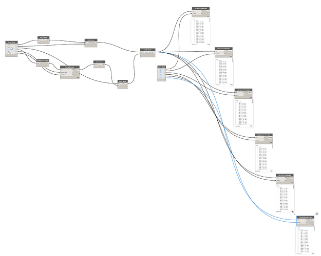

if that is what you mean, you dont plug them into the input nodes. delete the input nodes and just plug the list nodes directly into the nodes you want,
You should be able to pull the lists of inputs into the == node directly if you adjust the list lacing to longest and set the first input to level 1 (@@L1). Assuming n elements were selected, you would get a list of n sublists containing a boolean for each input A and input B value.
From there you can use a List.AnyTrue node set to @L2 for the input to get a single boolean value for each element. You can then sure those into your && node and move on with the graph.

See the below GIF ?: Currently, I am following this.
by doing this way it will take too much time.
Animation

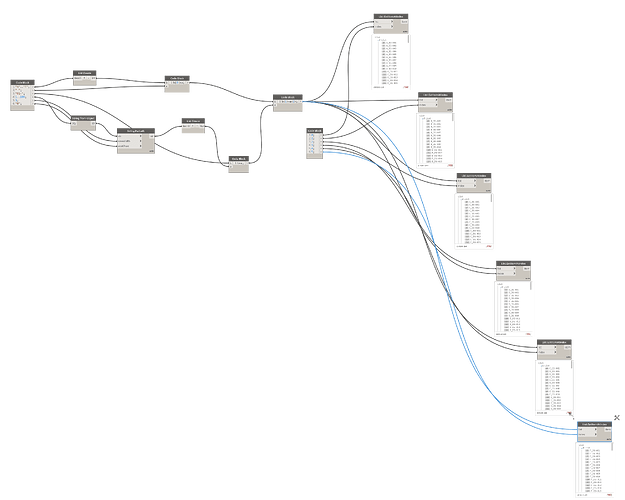

as i said before dont use the input nodes. see picture below.
plug in the groups seperetly.
