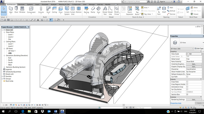

Hi Kulkul,
Please see the attached image for the revit model done using mass.
I am unable to covert to curtain wall, on the mass roof/wall.
Any advice?
Thanks.
Mee Yan
This is an interesting form to work with.
In short, be more specific about your goal and upload a half-done dynamo script file. Please.

Frankly if you are not intend to use dynamo to solve it, this is NOT the forum for you as I understand.
But to help, I can tell that the form is quite complex because
  1. the smooth/abrupt bifurcation in the middle suggests different patches;
  2. bottom left has a shape end, bottom right looks like a wrap - different modeling technology;
  3. the profile is wavy so rationalization is another challenge.
Therefore, I think you might need to look at the rhino-to-revit workflow(just google it) and NURBS modelling for the surface form.
Revit’s mass should be the container where you import the form from external modeling software. I am sure that you can, however, model this form in mass environment from scratch – but that really hurts.
