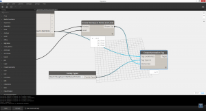

i created a list of rooms (in the example 3)
i selected an annotation family (room tag) and input it to the create annotation tag node
i input the room location as location for the tag
i use the node “create annotation tag”
result: “null”
any experience?

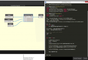

i created this custom node.
didn’t check if it is still working in 8.xx or 7.xx
How do you get the location of the rooms to use to place the tags (assuming the rooms are pre-existing)?
Ok, I’ve answered my own question. Used the lunchbox room element collect to extract the various rooms’ locations. Now to figure out your custom node.
