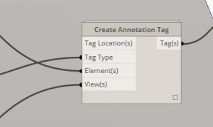

How do you calculate the tag location for this node? I have tried getting the centroid of a floor to tag. I can get everything to work except the Tag Locations(s) part.

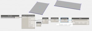

I think it’s because you’re extracting the centroid of the solid of the floor and that is below the 2d plane of the level. What if you try to extract the average point of the floor boundary instead? You could use the “Point.Average” from the ever evolving Clockwork tool
Thanks I will have to come back to this one as it seems to work but for simple slabs but not for complex ones.
