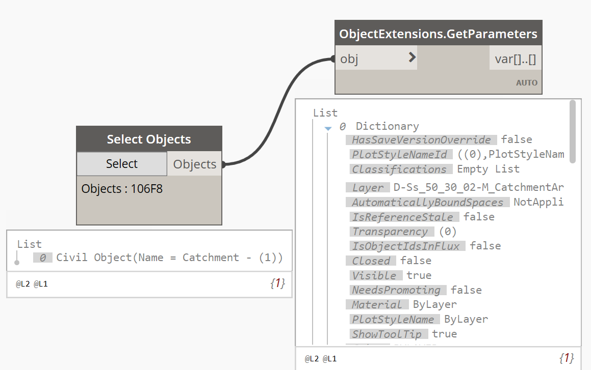

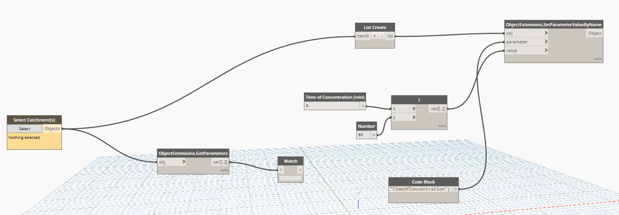

Thanks for the prompt response. I have tried your steps but I cannot get the time of concentration parameter.
Catchment-Set Time of Concentration.dyn (13.6 KB)
@KirkWM , Thanks for your answer.
i have tried your solution but it is not working for me. It does not change the time of concentration value for the catchment. :hot_face:

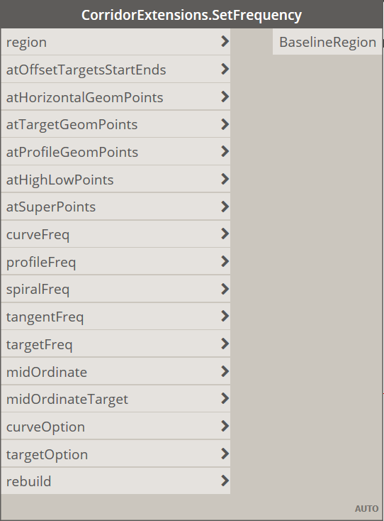

I am wondering if you can add in the next updates a node 1)to add baseline (Featurelines) for existing corridor .
2) Node to reset the frequency of regions in the corridor.
regards

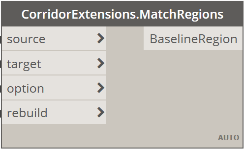

It works even on regions of different corridors

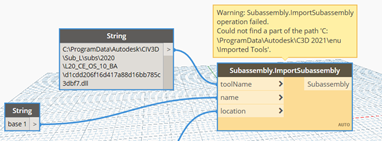

is it possible to add to the Import Subassembly node that we have subassemblys stored elsewhere and not C:\ProgramData\Autodesk\C3D 2021\enu\Imported Tools, such as in the folder: C:\ProgramData\Autodesk\CIV3D\Sub_L\subs\2020.
Kindest regards.
no

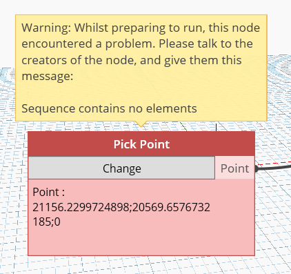

I am getting an error while using the node “pick point”. Please find the attached image for the warning shown.
I am using Civil 3D toolkit 1.1.22
Just add an item to the drawing

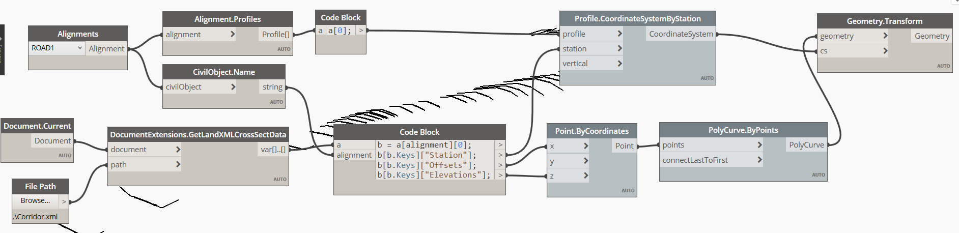

LandXML Corridor Cross Sections
@Paolo_Emilio_Serra1 I am facing the same issue.
