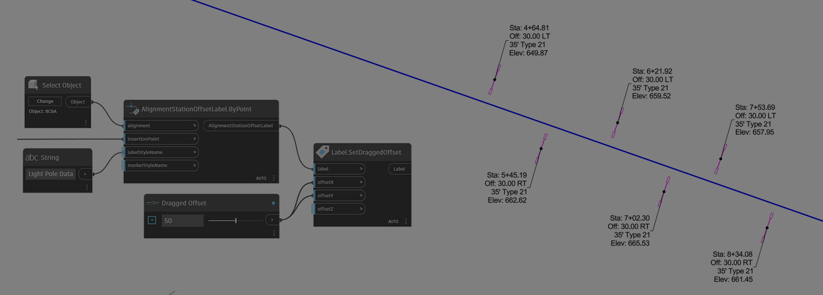

In case you missed it, Civil 3D 2025.2 is now available, along with a bunch of Dynamo improvements! Here are the highlights in this release:
:label: New nodes for labels to help with automating plan production
:radio_button: A new Pick Point node to make it easy to specify a point in the drawing
:information_source: In-depth documentation and sample files for AutoCAD nodes
:train2: New nodes for additional railway cant parameters
And here’s a blog post with more information. Hope you enjoy!
