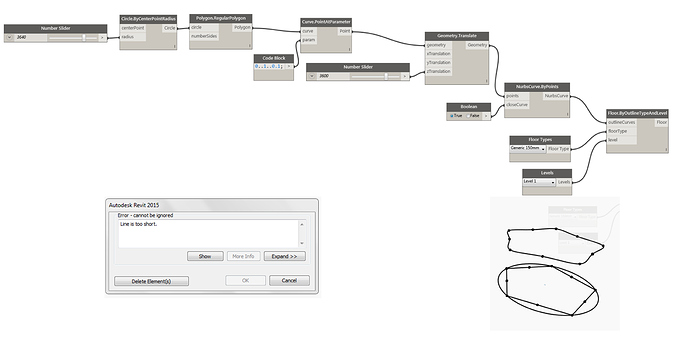

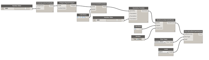

Try to draw a spline floor through the revit ui with a single closed curve. This is something that revit simply does not support…

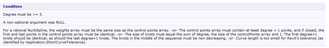

Oh yeah, Dimitar is totally right. That piece of documentation in Revit API forgets to mention that closed Nurbs Curves are not acceptable either. You will need to cheat the system and basically split this into two open curves or inject it with yet, another type of curve like a small line segment. Revit SUCKS!
