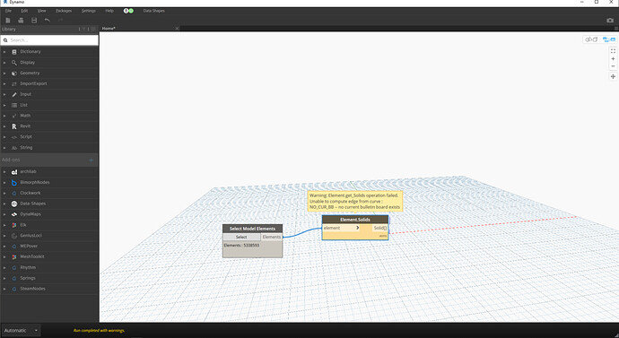

So i have had a script that has worked perfectly for over a year with no issues and i open dynamo up today and i cant event get the geometry of an element…
I even created a basic Model in Place Element and it still didnt work. Any idea whats wrong?
I think it is because of geometry. Can you create geometries and then trim them in Dynamo manually so as to see if it is all about combined geometry?
I mean: Try to create an extrusion for big part and for gaps also and cut them in Dynamo.
