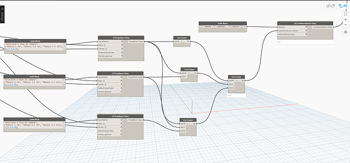

i’ve seen the new Data-shapes node called Ui.Conditional Input Node.
It is really nice, i managed to make it work but i want to make an optimization in my UI.

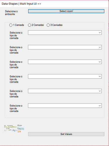

My question is: when i run the code i have 6 dropdowns… i would like it to appear only 3.

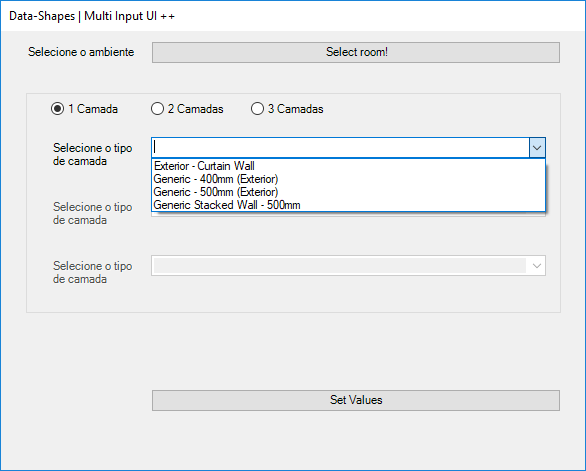

So when the user select the option “1 Camada” the input makes the user uses the first dropdown.
When the user select the option “2 Camadas” the input makes the user uses the first and the second dropdown.
I’ll attach the graph.
Thanks everybody for your help! Dynamo FOrum.dyn (20.9 KB)

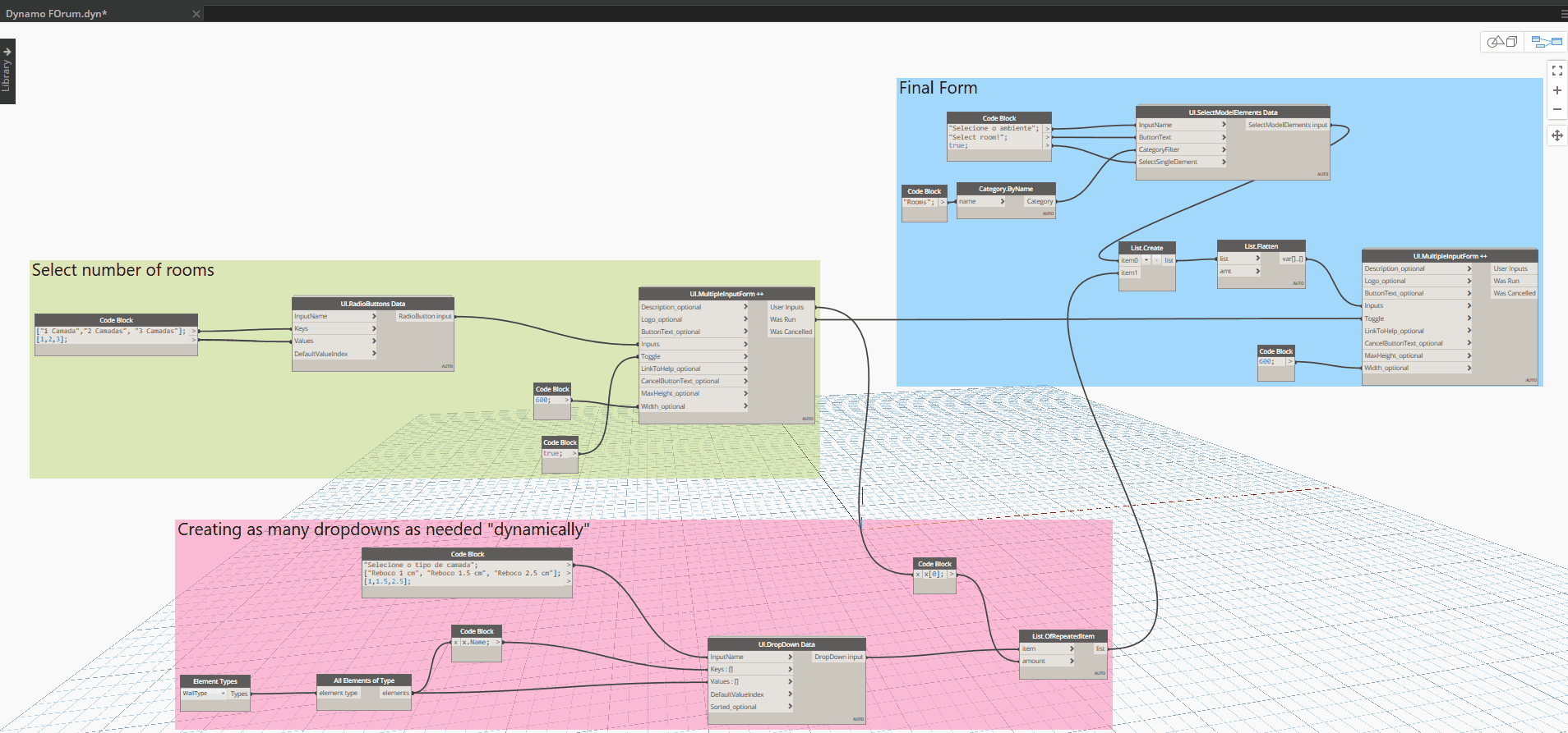

Will let you know when I have something working. I the meantime, Here’s a little workaround to dynamically generate the right amount of inputs: Dynamo FOrum mod.dyn (41.3 KB)
