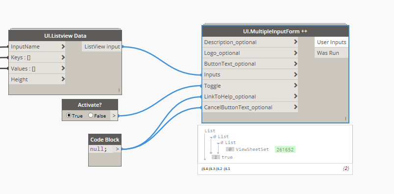

Ok, quickly tested this with the latest Data-Shapes package as I was using an old version. The issue is with the two inputs highlighted belowâŚ
They require a value in this build even if they are null. If you plug in null they should runâŚ
@Mostafa_El_Ayoubi, I had a quick look under the hood and updated these two inputs fromâŚ
: string = null
to
: var = null
also shown below. This getâs the UI node working nicely. Not sure why it doesnât like the string = null though.

@Daniel_Woodcock1 - The input definitions do not need to be changed, in fact they shouldnât as they check for the correct data type. The issue here is the following (standard Dynamo behaviour):
- A node gets updated and the new version has more inputs than its previous version
- You open a graph that already contains an older version of that node with less inputs
- Dynamo adds the new inputs to the node in your graph but âblocksâ the default values of those inputs
To resolve this simply right-click on the inputs and you will be presented with an option to use the default value for the input.
Any newly placed instances of the node will immediately use the default values of the new inputs without having to âunblockâ the new inputs.

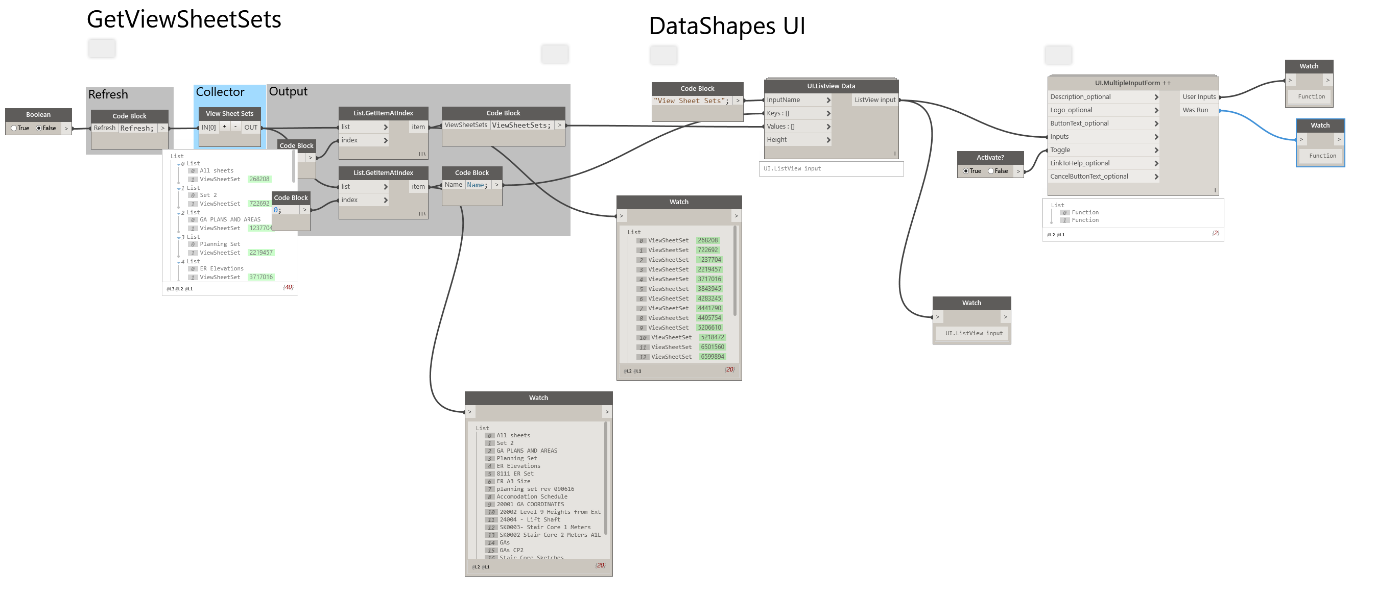

Thats great guys - thanks. One last thing though - when I plug that output into the get views from viewset node it returns a null value even whereas the result from the ordinary non UI select viewset node works fine. Any ideas ?
Have you verified that that node can process a list of viewsets?
@Phillip_Sheridan, could you post your .dyn file so we can have a look?

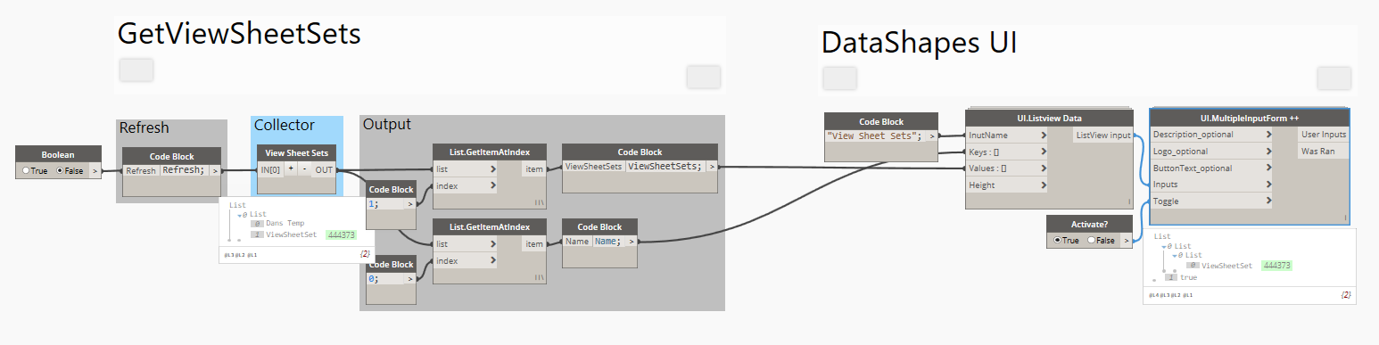

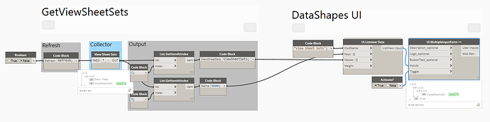

Sorry to be picky, but in your first screenshot you are feeding a list with a single item into the node, whereas in your second screenshot you are feeding in a singleton. With Pyton-based nodes, this can make a huge difference. So again, can you verify that the node accepts a list of viewsets as its input?
Andreas - Yes I know - the second one is one I was comparing it with, that works but doesnât do inputs from the User Interface nodes. It appears that the âget views from view set nodeâ doesnât take lists, but I donât know how to verify that ? Also I donât know how to convert a list with a single item to just a single ânon listâ item.

Yes, my suspicion was that it doesnât work with lists. You could check that by looking at the Python code in the node. Since your passing data from a ListView, you would potentially have several view sets selected, so you need to teach that node to accept lists. You can either do that by using List.Map or by setting the list level of the input to @L1 (I think).
Converting a list with a single item can be done using List.FirstItem btw.
Andreas/Daniel
Brilliant thanks for all your help - the List.FirstItem node fixed the last problem.
