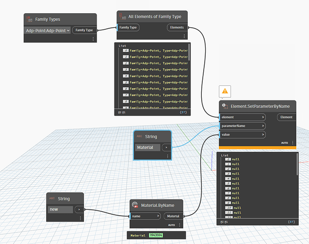

Hello, I got issue to change material in Type parameter. Element Set Parameter Value node works for instance parameter. Any idea to change type parameter in family.
You need to feed the actual Type and
not the Instance (the placed Family).
You can tell the difference by
their ElementId.
However, that being said, there is a node called
SetParameterValueTypeOrInstance
(I forgot which Package. I guess Clockwork or GeniusLoci) that will probably ‘do the trick’ also.
it’s part of the rhythm package
Thank you a lot. It works.
Thank you for your information.
