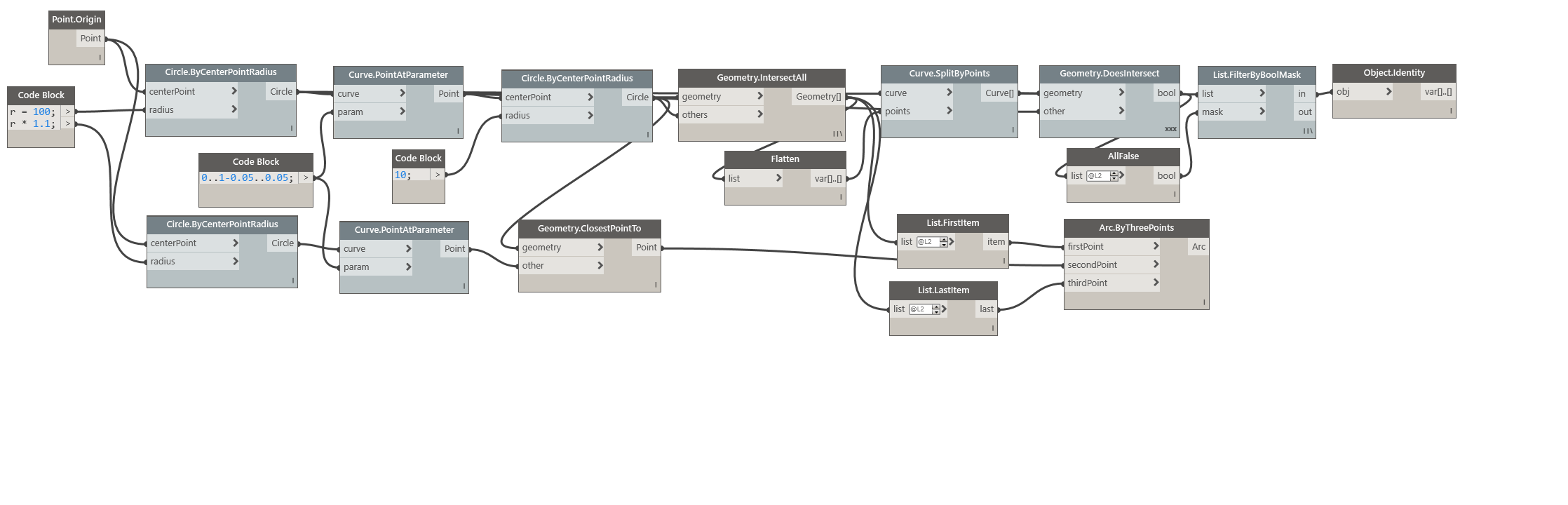

I have created one big circle which has radius 15 and 14 circles along big circle. Now the issue is I am trying to trim 14 circles by the big circle (radius 15). How can I do that?
Attached screenshot for your reference please.

I have a partial solution for you, that uses some of Dynamo’s geometry quirks:
@Farjana_Akter alternaively, this should work:

This is how I solved :smile:
Option 1
Option 2
The entire graph as shown below
The Dyn here :smile:
