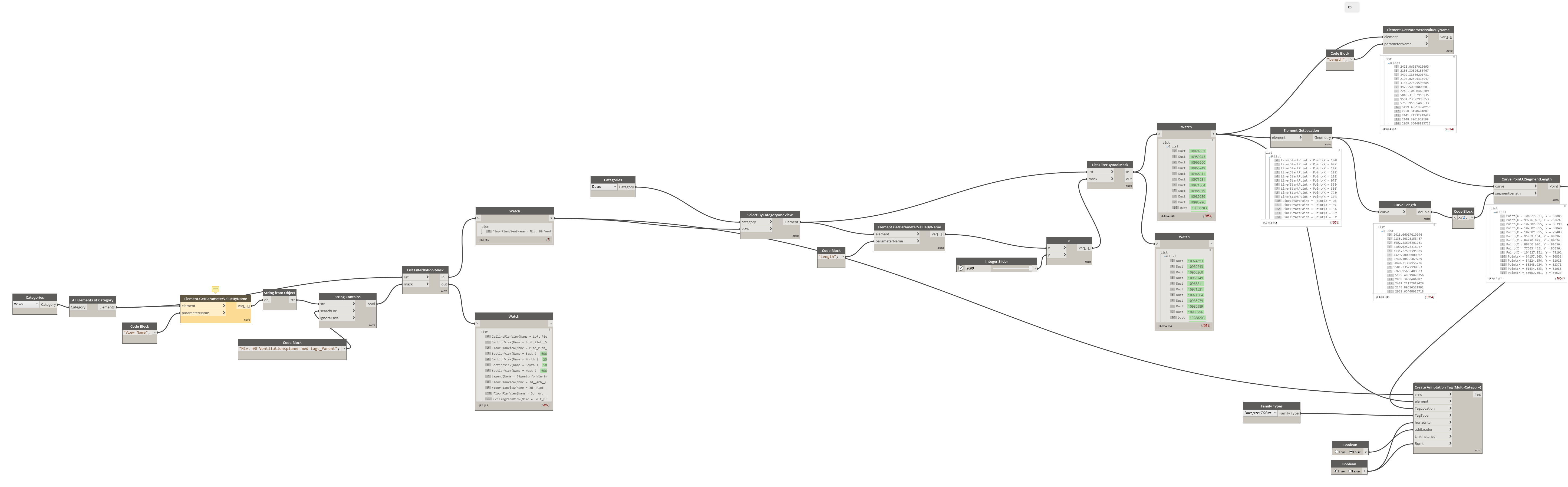

I am trying to get Dynamo to tag all my ducts in specific views, that are more that 2000mm of length.
So now I have made a new graph to do this. It has found the ducts, that needs to be “tagged”, but, when I press “run” it just runs in the background, but it does not place the tags… !

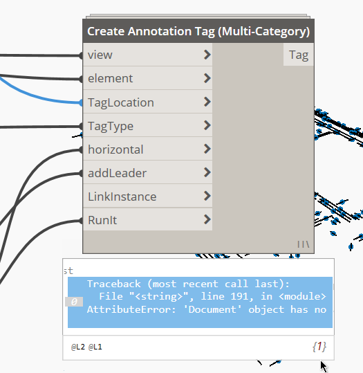

All your inputs are list of list so set the longest lacing on the Create Tag node.
Your version of the package seems really old, you should install the updates.
Its Revit 2020, and Dynamo 2.3.0.5885 and If I try to download a newer version of the Loci package, it says “The package uses a newer version of Dynamo”. So is that not a problem…?
And the error message says:
“Traceback (Most recent call last):
File “”, line 191, in
AttributeError: ‘Document’ object has no attribute ‘NewTag’”
The Genius Loci package is compatible with all versions of Dynamo, so no problem.
The error message indicates that you are using the wrong node. (API method deprecated)
