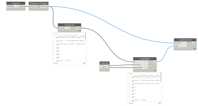

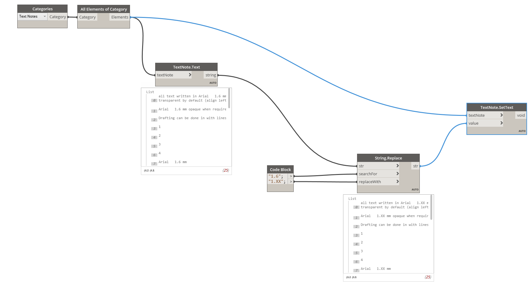

This is what I currently have…but is only good for one set of string variables

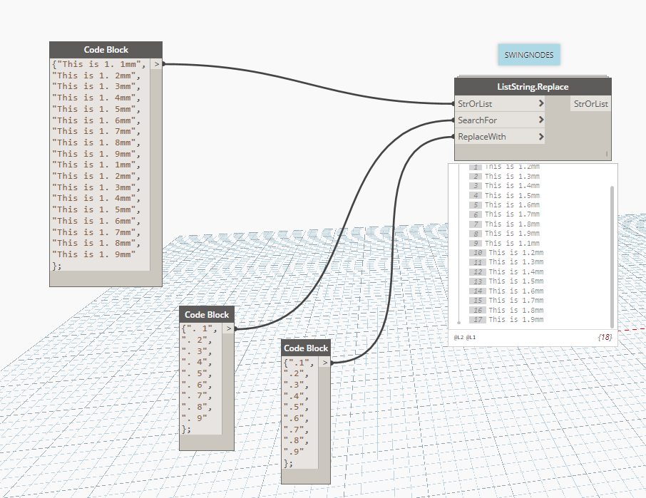

@Ashton_at_Hierarchy Download the SwingNodes package
Thanks @salvatoredragotta, that’s ideal!~

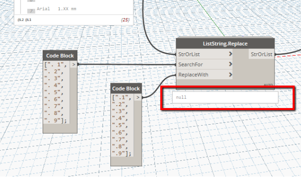

@salvatoredragotta… I’m close… but what’s missing here?
Convert to string? What does the error say?
Warning: TextNote.SetText operation failed.
The input argument “text” of function Autodesk::Revit::Proxy::DB::TextElementProxy::Text::set or one item in the collection is null at line 214 of file d:\ship\2018_px64\source\detail\detaildbapi\gensrc\APITextElementProxy.cpp.
Parameter name: text
you are using square brackets instead of squiggly ones {}.
Not sure if that is it or not but square brackets are not allowed to form a list before 2.0 and I have not tried it yet. Do they form a list?
Thanks Steven, using the most up to date Dynamo, which forces the square brackets instead of curly
Thanks for bringing me up to speed on the square brackets.

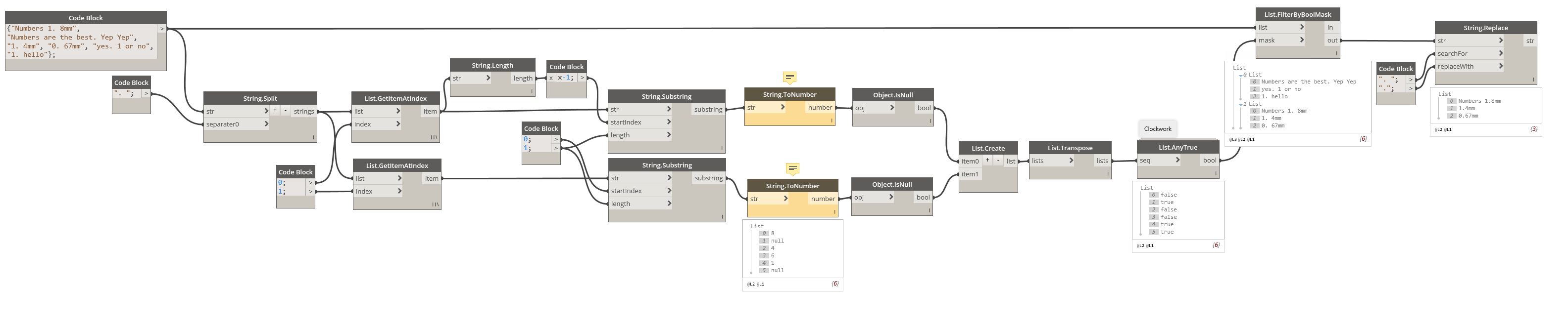

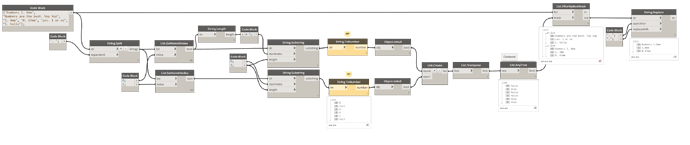

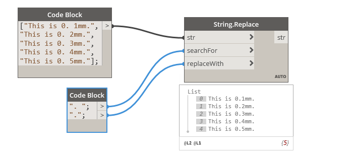

This is not the most elegant solution but it will work for you. Its all OTB except for one Clockwork’s node at the very end.
Wow! that’s elaborate… I’m very fresh to Dynamo so trying to learn on the fly. Thanks for all your help!
I just ran another test and it does not work if there is more than one period in the text string. I do not have time to figure it our right now.
If you are new what I did is a good learning opportunity for following data. You do not need to use it but it could help to look it over. All I did was remove all strings that did not have a number before the period and after the space. This figures out what is a period and a decimals. Feel free to PM me with any questions.

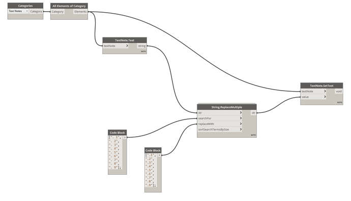

I just found String.ReplaceMultiple in clockwork package. you can give it a try too.
Hi @salvatoredragotta … sorry 1.3 didn’t work either!
I’m going to give @Steven solution a shot early next week and will update you all then!
Thanks for all the help!
@Ashton_at_Hierarchy Please share your RVT file
@Steven & @salvatoredragotta - THE SOLUTION IS AS ABOVE! String.ReplaceMultiple worked like a treat.
