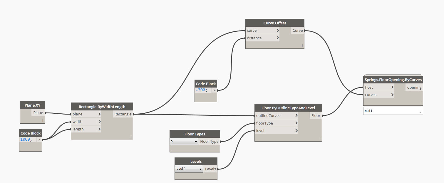

I want a hole in a floor .
I use Springs.FloorOpening.ByCurves.
but get a null.
FloorOpen error.dyn (9.4 KB)
I have solved by myself.
FloorOpen fixed.dyn (11.9 KB)

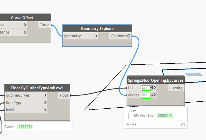

You don’t need the list.create nodes, you can achieve this with the node’s levels:
