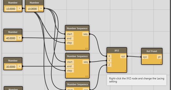

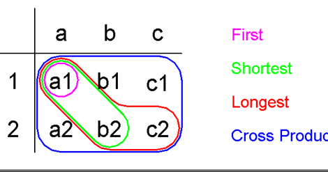

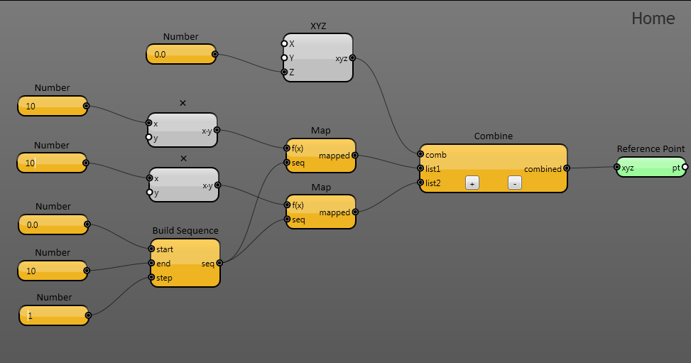

Just a quick question, in Ben’s first response he was talking about setting the lacing. I’ve come across multiple incidence were i had to change the lacing, but i really dont have any idea what it means! I searched for an explanation of it but cant see to find any thing about it.
Mabye one of you can give med a quick guide to how it works?
Have a look these blog posts by David Wood on lacing (oldies but goldies):
Very helpful, thanks!
