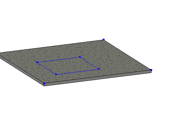

I’m trying to use differents nodes to open floors but it doesn’t work…

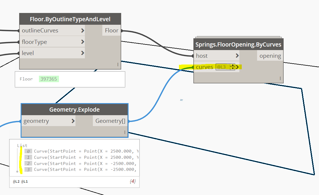

I have this :
Where is my mistake ??? I saw others topics about that but i didn’t understand what’s wrong…

Openings must be defined by curveS (not closed) and level set up to L3.
It should work.
