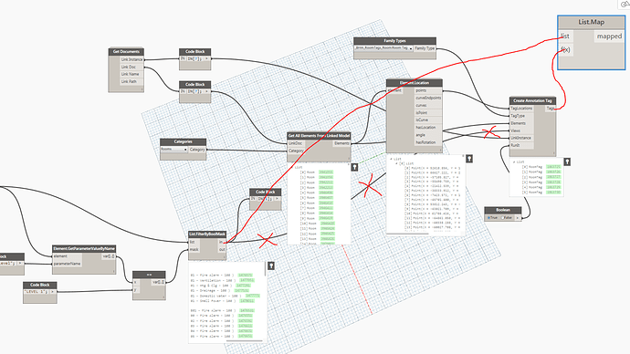

Hi All, I’m trying to tag rooms from linked models. The script attached will work for a single view but not with list input. Has anyone done anything similar that could help?
I have used nodes from Clockwork and Archi-lab packages. Dynamo 1.0.0 & Revit 2015.
SpaceTagFromLinkedFile.dyn (22.0 KB)
Hi @Lknapton
try this:
That’s great, thanks
