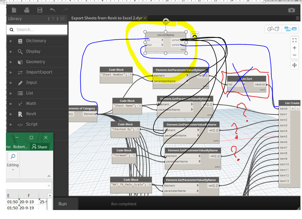

I can’t get solve this. I want to export the Revit Schedule to Excel as shown in the Schedule.
The first column I can sort it as shown but after it I can’t figure out which type of sort by then I have to use. See the picture

I get lost right now, I want to remove “T-00” and “S”. as a name. Not use a number to remove it because, in other projects it can have a different number if I have more or less sheets. With which and what do I have to connect “List.RemoveItemAtIndex”?

I tried something (see screenshot) but nothing happens. It would be nice if I don’t need the Sheet numbers to delete it because in other projects, the consecution could be different but the name always is equal.
It is the name of the (parameter: Sheet Number), I don’t have another name or number for it. It does export to excel. Do we have to use the “List.RemoveItemAtIndex”?
