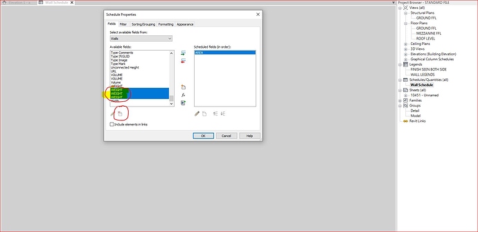

I want delete these field as above image. These are a shared parameter but i can’t delete these.
Please help me…
Manage > Shared Parameters ?
no, it’s not seen.
Is it possible for you to upload the revit file and let me look into it?
sorry but i can’t send the revit file.
due to more than 3 shared parameters file uploaded in one project it’s show more than 2 or 3 same fields please give any solutions if you have
