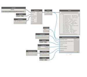

Is there any way to feed in a list to the Add shared parameter to Project node? I’ve got a list of 125 parameters that we use for room data sheets but i’d like an automated way to add them to the project. Any thoughts?
Thanks for the response Konrad. Unfortunately I just get a null. Thoughts??
What you doing is not the same or even close to what I sent you an image of. Please try again.
For anyone wondering…you need to pipe in true/false statements for however many parameters you have and it works great.

Here is a definition I made not too long ago. Only real difference is I’m feeding in an excel list of parameter names. If you are getting nulls make sure a shared parameter file exists. If the shared parameter .txt file isn’t there the definition will error out.
