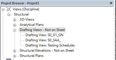

Yes my project browser is sorted by “Classification”. See below my project browser snap. Yes, This is just a test file contains (2) drafting views on one sheet. But Idea is to sort all views in project browser with multiple views on multiple sheets.

@Mitesh_Gajjar double check your Browser Organization. In your screenshot above it is reading that your Browser is being organized by Discipline.
@awilliams, My project browser is grouped by Discipline and then by classification.

None of my drafting views shows correct classification parameter otherwise they would have sorted properly.
