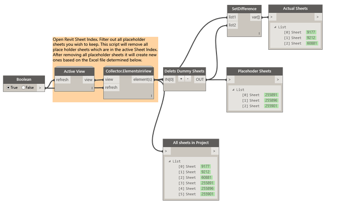

I am not sure where I picked up this bit of code. Sorry to whom ever wrote it and feel free to accept credit because it has been a huge help to me. This will solve all your problems (or should at least).

ignore the text in the orange group. I coped those nodes from one of my scripts.

@Steven_Hansen Did some modifications to what you have here to work with my workflow and it works great!! I was looking into IsPlaceholder yesterday but wasn’t sure on the rest of the script so it helps a ton.
Will post the Image when I get more organized!
Thanks so much!
Chris

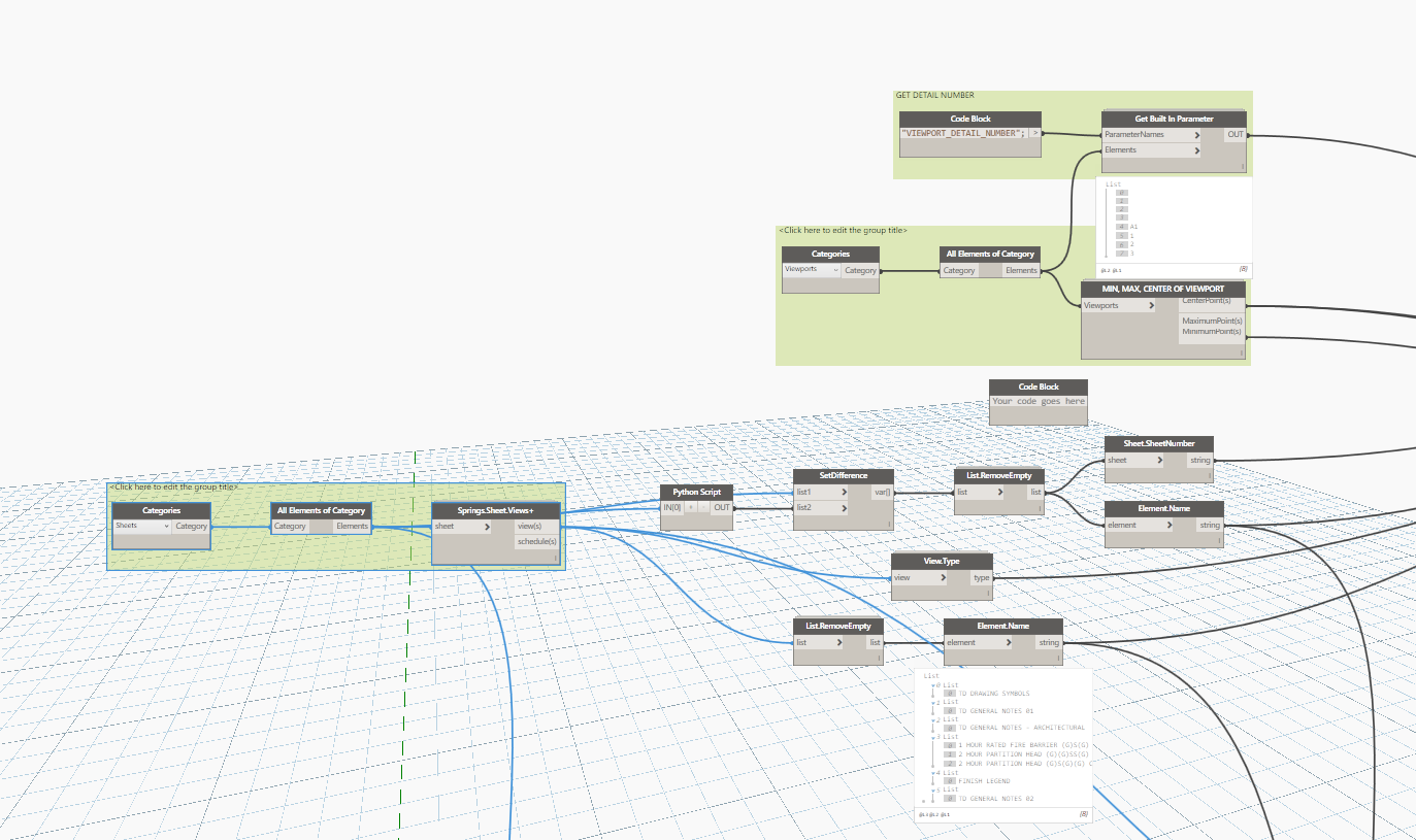

This is what I got working, still doing some matching of data but all good otherwise! Thanks everyone
