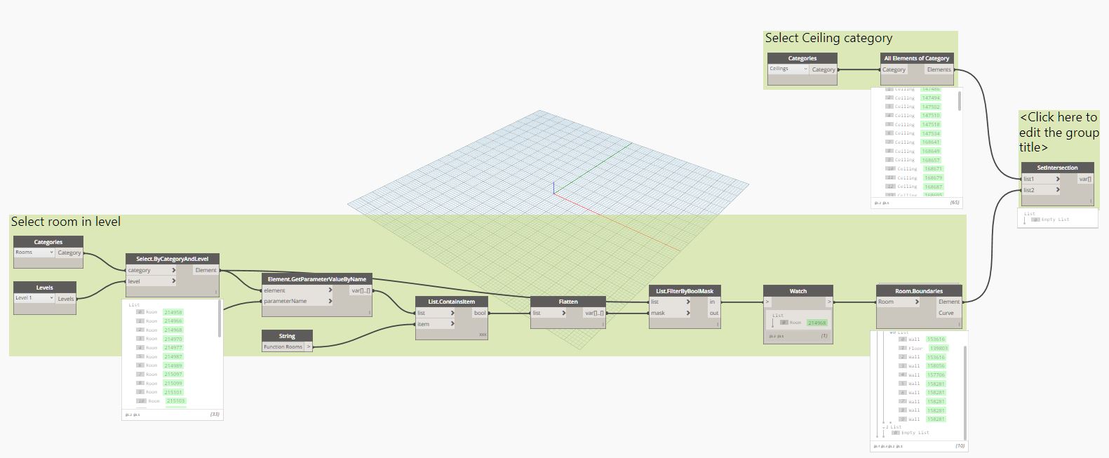

Hello All,
could you please help me to find how I can filter ceiling to be able to select ceiling in specific level and room, I have tried but I could find the correct node, What I miss ! see below
Hi @omarbsbg,
I advise you the Room.Finishes node from Clockwork package to find the associated ceilings.

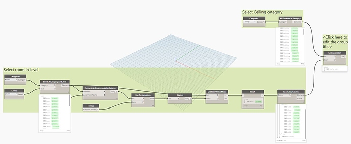

Hi Alban,
I’ve tried to reproduce this script on my project file but I didn’t be able to.
Can you please explain to me how you got the node Room.Finishes ?
And for the other custom node you created " SelectByCategoryAndLevel" I tried to got it by this script below but I had error:

Hi Thinhinane,
Welcome to the Dynamo Forum.
You must install the required packages (Genius Loci and Clockwork) on your computer to obtain these custom nodes :
Of course the ceiling must be within the boundaries of the room to be found.
An example with the Genius Loci package.
