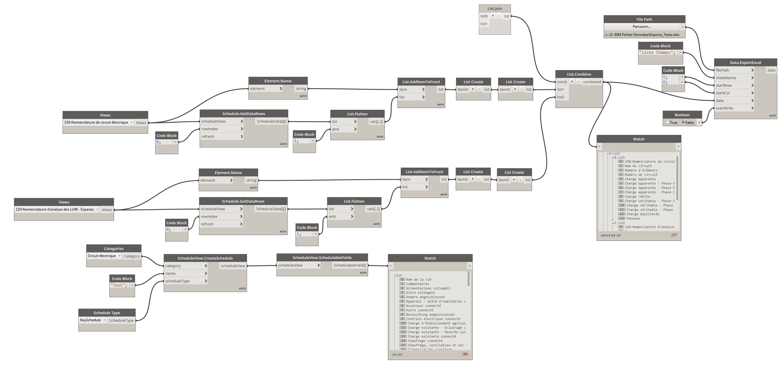

I join my result after some search
Daniel
That is a good first attempt. Are you just trying to put together a list of the view headers with the view name in the front? This might be a better workflow:

Re,
In finally i want to extract some Schedule that i want to inject in new project al in one time
First item = Name of Schedule and next all that i want in my Schedule
I am electrical technicien, and i have 30 Schedule specifics for controlling moddilisation of my project
I don’t want to create Schedule in my Template, i prefer to inject (auto-create) them
Daniel

In REVIT 2017 with Dynamo 2.0.2.0
I can’t create Schedule with
ScheduleView.CreateSchedule
Category don’t work
Have you some solution for this ?
