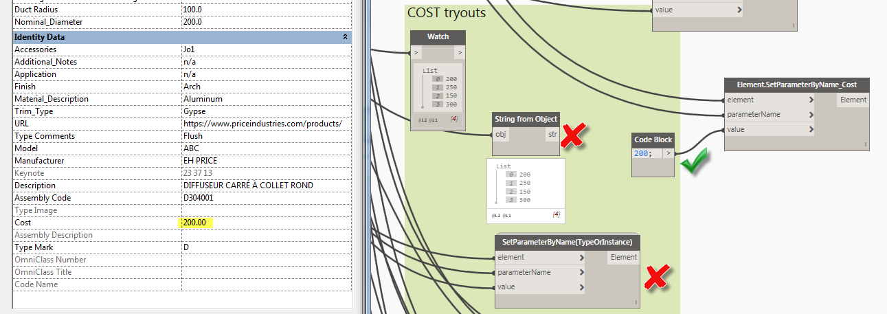

Update on different manual trials:
Following @Kulkul’s URL solution I applied it to all the other Type parameters
With the following results:
- Greyed out parameters are “read-only”
- Other parameters that don’t work “The parameter’s storage type is not a string”
Cost Parameter
How do I get each Revit Type family to get their Cost from the Excel file?
