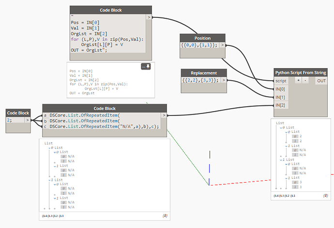

to add another layer to this, ultimately i would like to make the indices a list of lists.
for example see below. not sure how this would work but i am sure it can be done.
lets say the first entry is replace index (0,0) with values (2,2) and the second entry is to replace index (1,1) with (1,1).
the two nodes I am using, do not do this correctly. end result should look like:
Capture%202
It must have happened when the package was recoded from Python to C#, as I said my package is old (one of the first versions) and I will not update it till my current project is finished :slight_smile:
But you can, as I mentioned earlier, use python to accomplish your task :slight_smile:
Pos = IN[0]
Val = IN[1]
OrgLst = IN[2]
for (L,P),V in zip(Pos,Val):
	OrgLst[L][P] = V
OUT = OrgLst
@Jonathan.Olesen, appreciated, the python script does the trick.
