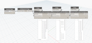

With the newer version of Dynamo, I am able to use Sheet.SheetNumber & Sheet.SheetName nodes to extract data. As seen in the left image, using a String & Element.GetParameterValueByName causes some problems as it skips ONLY Sheet Numbers randomly (only in Revit 2015), thus I change to the new nodes.

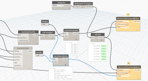

However, as I want to SetParameterByName from reading from excel, I will not be able to connect the new nodes to the parameterName (right image). If I were to use a String & ElementGetParameterValueByName again while reading data, it would also cause similar problem of skipping data randomly.
Thus, I would like to know how should I go about linking “Sheet Numbers” to the parameterName through other nodes.

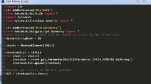

How would one get Sheet Number using Python? Has someone tried this to see if it is more reliable than the Get Parameter node?
See Attached Image for Python method. Also, don’t forget that there is now a Sheet.SheetNumber node that does this. Both methods are reliable and don’t produce the nulls that element.getparametervalue does.

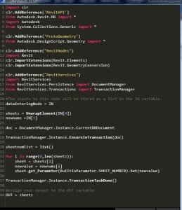

I just went back and read the OP issue. To set Sheet Numbers via python, it’s very similar to the read sheet numbers method. See attached:
