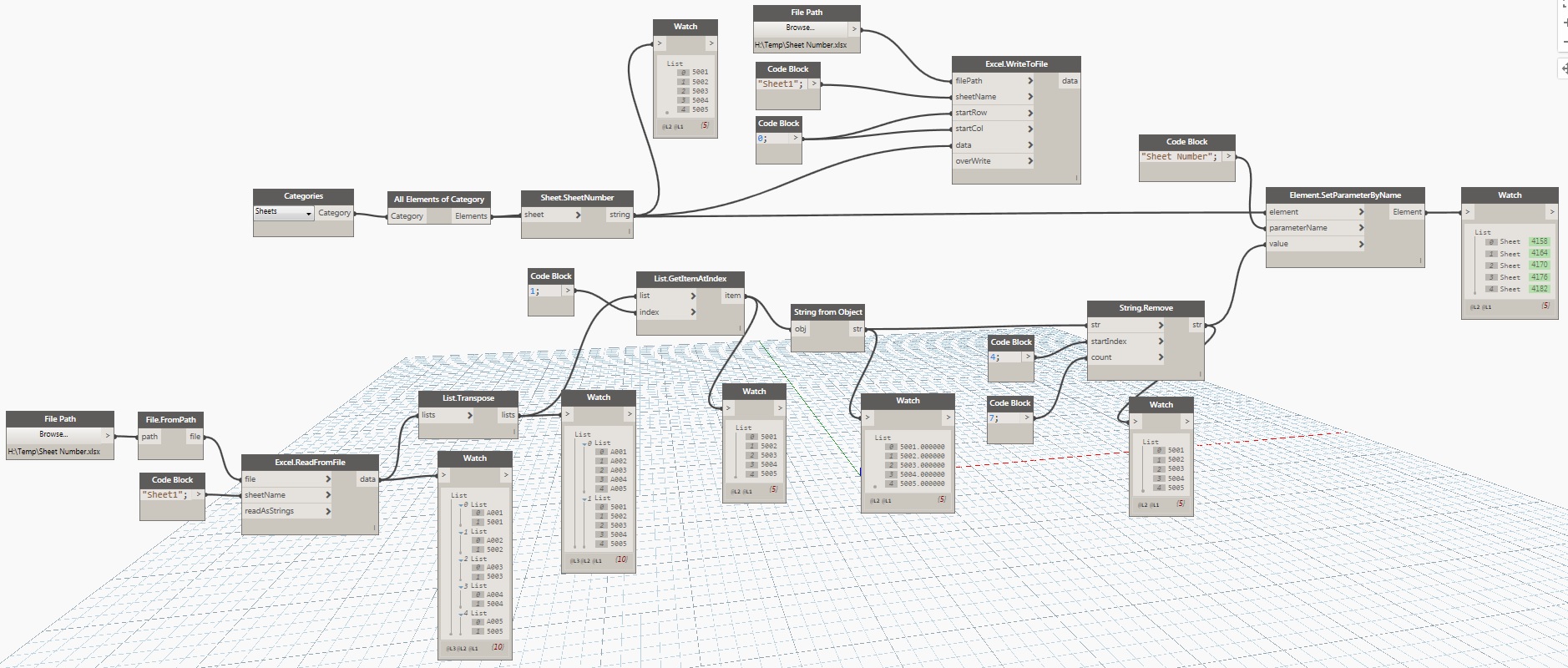

Hello Guys,
I have tried to create dynamo graph to change existing ‘Sheet Number’ to new sheet number from excel.
But i can not get expected output.
I want to change sheet number from ‘A101’ to 5001 & so on.
Refer below image.
Change Sheet Number With New Number.dyn (13.4 KB)
Sheet Number.xlsx (8.5 KB)
Please advice.
Thank you.

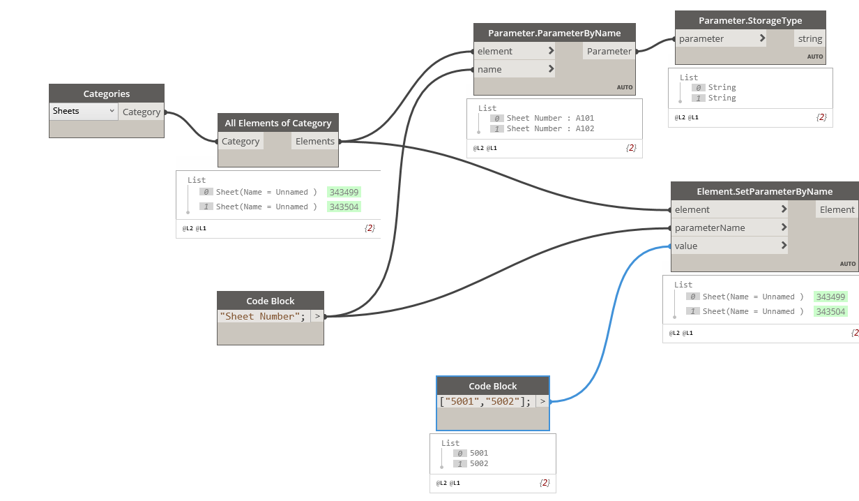

it’s always a good idea to use Parameter.StorageType to check if your parameter is a string, an integer etc…
In this case you need a string, maybe you are using integers/floats? Give a try with a StringFromObject node to convert from numbers to string.
Also I would use the OOTB node Element.SetParameterByName

They are both OOTB, but it might be that they were not yet available in version 1.2 (but in 1.3 they are).
http://dictionary.dynamobim.com/#/Revit/Elements/Parameter/Query/StorageType
Anyway you don’t need them to solve the graph, I put them to show you that the parameter is a string.
What you probably need is to convert your values to a string, just use a StringFromObject node before connecting them to value input of Element.SetParameterByName
Helloo Lucamanzoni,
Thank you for your reply.
Now it is working.
Final graph is as below:
Thank you.

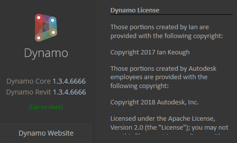

Hi , I was trying the same thing, but it doesn’t work as well…I done it exactly like @lucamanzoni graph
and it actually worked on Version 1.3.4 , the previous post was version 2.0.2
