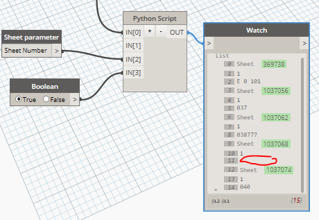

In my sample project I have 5 sheets created:
When I run the code it extracts some of the sheet numbers, but strangely not all of them:
You can see the circled one is blank.

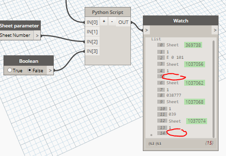

If I re-run the code (by toggling the boolean node to ensure it runs) it get a different result:
This time, you can see two of the values are blank.
Each time I run the code I get a different result.
Any idea why this is happening?
