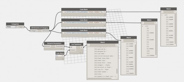

Does anyone know why GetParameterValueByName randomly skips values when requesting Sheet numbers? I’ve tried multiple ways to get a complete list but cannot figure out the logic behind the randomness of the skipped items. This only applies to Sheet Numbers, everything else runs perfectly. If anyone has a work around, I would greatly appreciate it. I have attached a screenshot with the operation running 3 times giving 3 different random lists.
Hello Travis Williams,
Sorry for the inconvenience, we are tracking this internally with issue ID MAGN-5870
Will let you know once it is fix.
Continue using Dynamo.
Thanks,
Ritesh

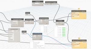

I’m trying to send it back to Revit from Excel. I have use the Sheet.Numbers and Sheet.Name nodes to extract the data. However, these nodes can’t be link directly to - Element.SetParameterByName, ParameterName as I want to retrieve the data. If I were to use a code block or string, it would end up with the same problem of skipping randomly. (This problem only occurs in Revit 2015, it doesn’t skip in Revit 2014, tested)
Do you have any workaround ?
Thanks & Best Regards
What’s the error you are receiving? The top one doesn’t have a parameter name assigned.
Greetings ,
I’m suppose to have a String Node (or Code Block) with “Sheet Number”, but it’s not going to work as it will be giving the same issue of randomly skipping through the list. I would like to know if there is other nodes that can input “Sheet Number” as the parameter.
(And therefore I leave it unassigned)
If you saw the screenshot from the original person, you would see that his Sheet Number has an issue, which is the same as what I’m facing.
