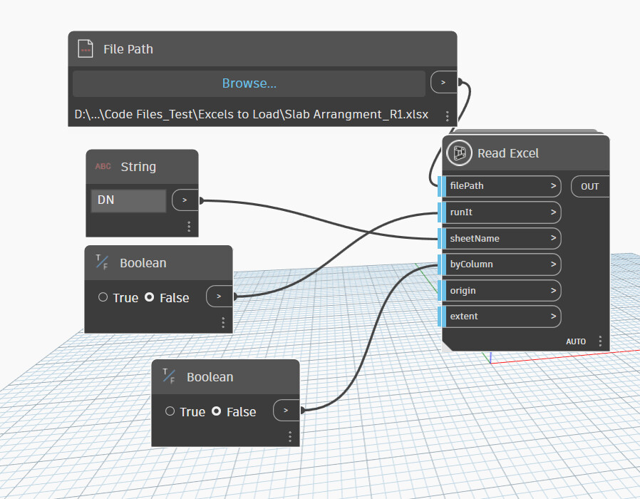

I am having some difficulty in reading the excel data. I am using “Read Excel” node from bumble bee package. Earlier i was facing some issue with excel data read using normal nodes so i switched to bumble bee and it was working perfectly fine until i updated my civil 3D to 2025 version.
Can someone suggest a possible solution.

Earlier I used to read using “OpenXMLImportExcel” only but there was some issue with this. Instead of reading the values from Excel, it was reading formulas from that.
This was the reason I shifted towards “Bumblebee” and it was working fine but after updating the version to “2025”, it’s not working.

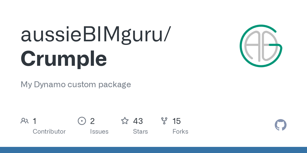

I’ve got some pandas based nodes in Crumple wip which should work in 2025 under crumple > applicatiom > excel:
