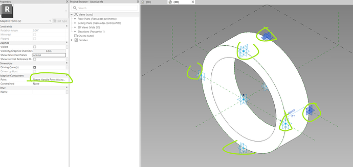

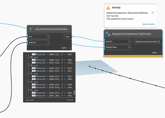

Good morning, I’m trying to use this family. It has two placement points and another eight manipulation points. I’m trying to place it along a path, but Dynamo tells me it has argument issues. I removed the nulls, but it still doesn’t seem to work.

I can make it work with only one placement point, and feed it several points in a list. How to make it work with several placement points per instance, might have something to do with the list structure of the points. others might have a clue on that.
Hey, made it work. As i suspected, you need to arrange your points in sub-lists. I’ve shown it with only two points, a and b. Which you have.
But something is wrong with your family,
i “fixed” it by deleting all the reference points, and leaving only two placement points behind…..

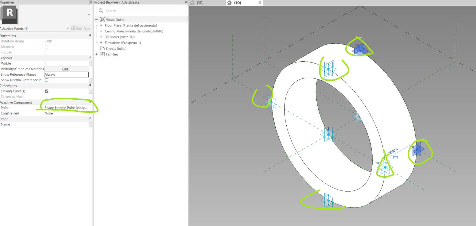

i just found out, that if you turn off the “adaptive” property of all the reference points, the family works!

Thanks a lot, I thought that to create the family I just had to insert the placement points

If your family uses adaptive points and shape handle points, the built-in Dynamo node will not work. Instead, use the node from the Brimohareb_XXXX package.

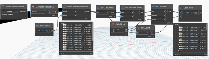

gave it a try. not too complicated, really; some list management would remove the last sub-list, which is just a single point.
place_adaptive_along_divided_path.7z (619.9 KB)
