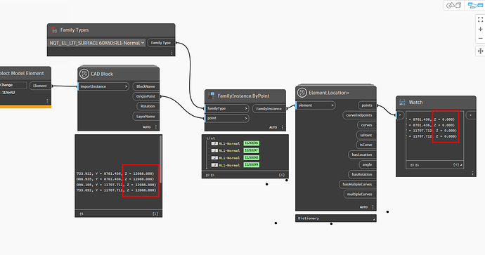

I have some coordinates from AutoCAD and I want to insert family instances in these points but as you can see the issue is the Z value does not read correct it’s always equal zero.

What is the Z-value in Autocad? :roll_eyes:
i previously changed it to 12088 as the first block says
Guessing the family type doesn’t allow placing off a work plane. Try another family like the desk model which comes with the standard template.
ty for the reply
and that is correct i tied another family and it worked fine but is there a way to do it for a family that get a host on ceiling like lighting fixture?
Ceiling hosted means you need to use one of the hosted methods, meaning you will have to provide not just a location but the element on which you want it to be hosted. I think the name is FamilyInstance.ByPointAndHost, but might be wrong. Going to the family instance section of the library should expose your options though.

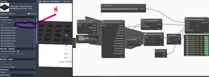

Hello @abdelrahmanelfeky6 here is a way with a face based family hosted on a ceiling on link, i use genius loci..could probably help
thanks it finally worked

yeah it should be possible as well, if i understand :wink: but dont have any example for try on…so cant show you…but i would try with some projection on surface from you cad block location or some raybounce maybe :wink:
i have a random cad and a revit with a linked arch to test
all i know about raybounce that it only detects things in my model. is there a way to make it also see linked revit elements?
yeah raybounce works on link as well, with custom nodes i guess bimorph and data shapes have for that, but seems in 26 we can get it ootb :wink:
found it on bimorph
thanks boss you are an absolute life saver :heart:
