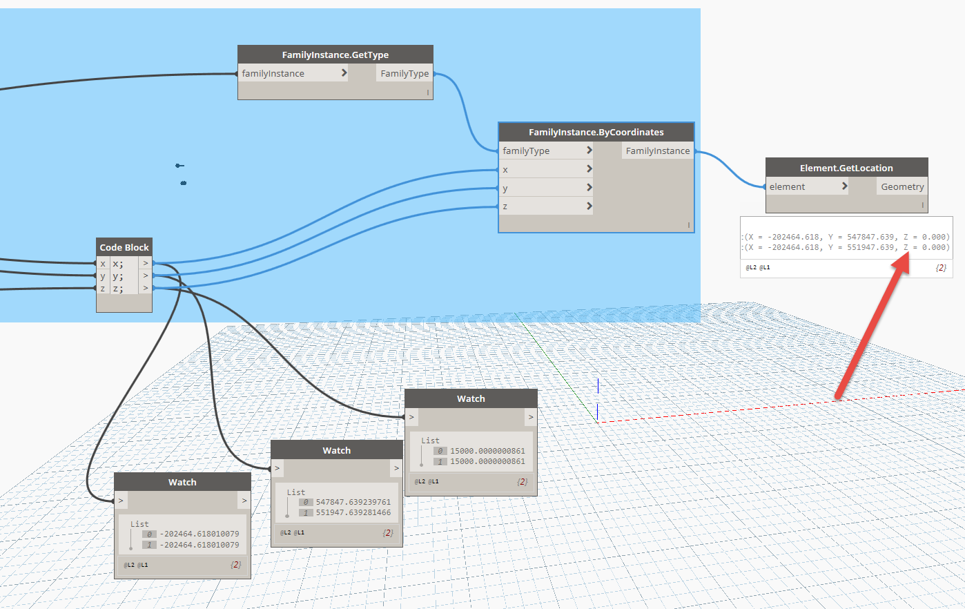

hello dears,
im trying to make a copy from a family to several location, im getting X,Y,Z needed, but when i use FamilyInstance.ByCoordinates the output have a zero value to Z , if there any answers for that it would be appreciated
thanks
Is it a hosted family? Are you able to manually place a family there?
yes it’s hosted to ceiling, and i don’t know if this valid, if not is there any solution ?

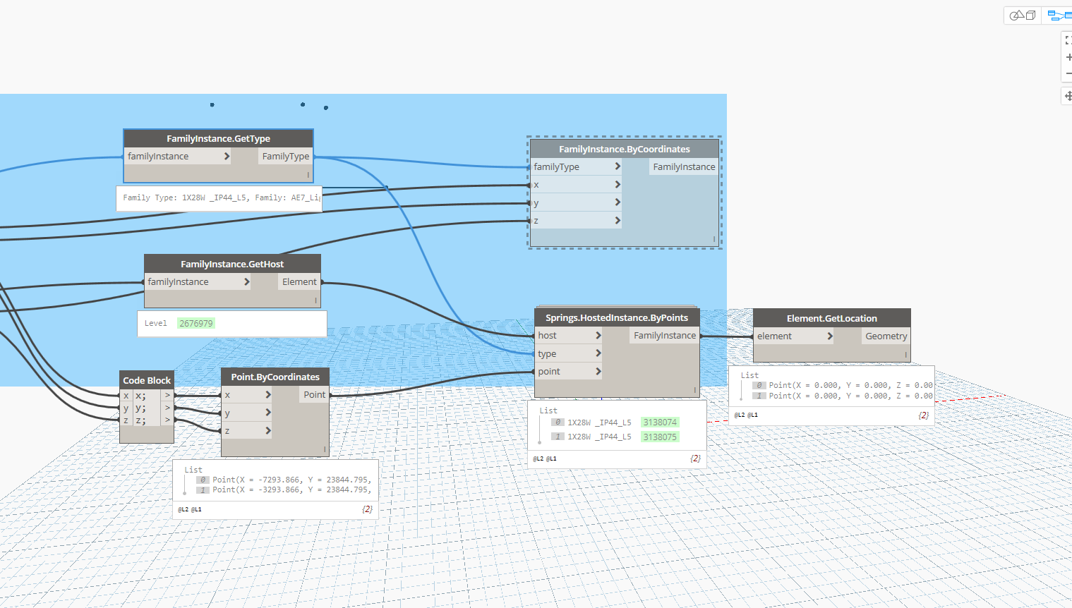

Springs has a node for placing hosted families.
i’ve tried it , it give me the same result
It is possible with the proper inputs. Can you show us what you get with the Springs node?
this is how i get the result, it give the points in the right position but no instances, the output from spring node XYZ=0
I noticed the host element is a level. Is the original element hosted to the floor level and given an offset? If so, you’ll have to do the same thing with your new instances - host them to the level then apply an offset.
EDIT: Hmmm… it seems like the hosted element does default to Z=0 even though it has a host. I tried using a similar but different method from the API and got the same result. @Dimitar_Venkov, do you have any insight here?
EDIT2: Using the OOTB node FamilyInstance.ByFace still locks the offset at 0 but does at least put the family in the correct location.
the original element hoted on level 01 without any offset, i have select it by Specify a new Work Plan window

i thinks the idea is we can set location for element in X,Y only, for Z we need SET HOST thing, that i dont know what we could use something that work as Specify a new Work Plan
