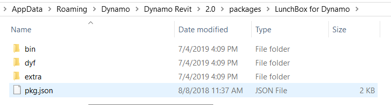

I’ve used the dynamo version 2.0.2. I just start learning the Dynamo software. Now I face the problem is that after installing the packages, I can’t see that pkg in the library. Can anyone help me explain?
Inside the bin, dyf folder, there is no file.
Inside the extra folder, there is one .txt file.
What is in the text file?
Lunchbox has a separate download, not from package manager.

Noted. Got it. Thanks Simon

Most packages such as e.g. ArchiLab package are installed using the inbuilt package manager. However the LunchBox package works different and is installed by a standalone installer.
