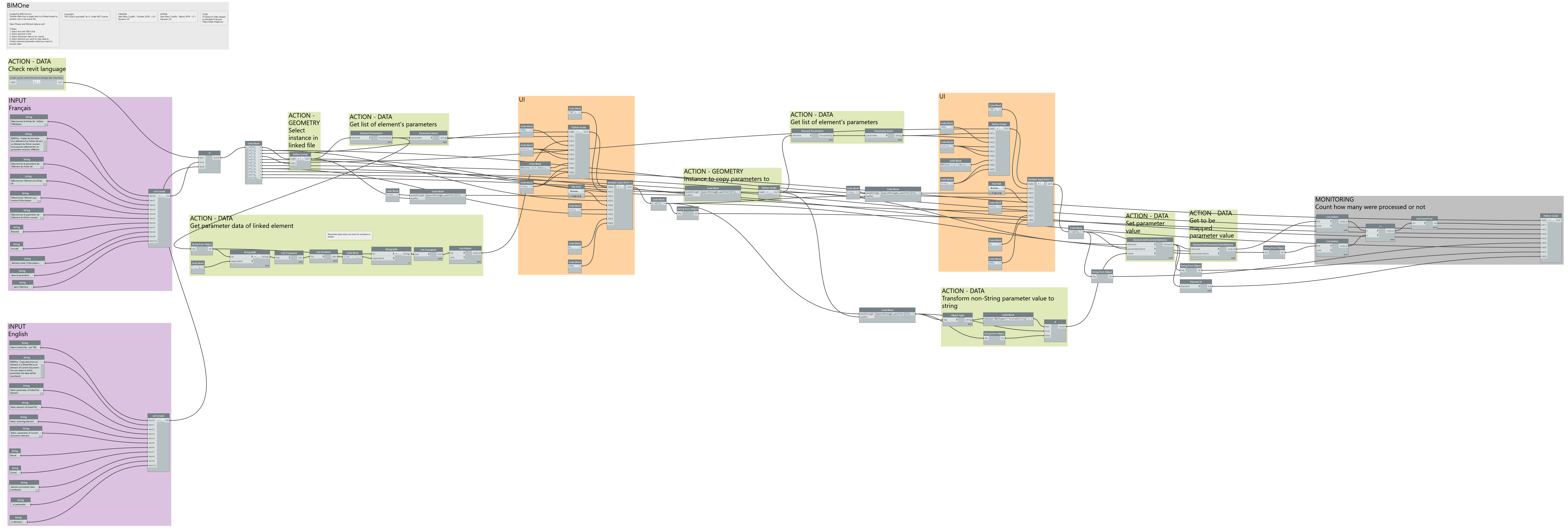

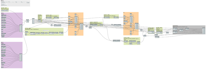

WITH THIS SCRIPT YOU WILL BE ABLE TO:
- Transfer the data of a single element present in a linked file to an element of the active file…
5-STEP PROCESS:
- Select linked file with TAB + Click
- Select the linked file item that interests you
- Select the parameter containing the data that interests you
- Select the item in which you want to copy data
- Select the parameter in which you want to copy the data
