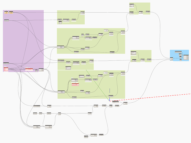

Nodes missing, only wires are showing. Revit 2017
This is only happening with Revit 2017, for both 1.3.3 and 2.0 versions of Dynamo.
The graphs open fine in Revit 2018 and Revit 2019.

Dyn attached.
MANAGE - DatumsCheckCurrentAndLinkedModels.dyn (68.3 KB)
Looks fine from my end: (Except for some missing packages/nodes)
Revit 2018.2
Dynamo 1.3.2
@Joaquim_Agostinho1 Try this file DatumsCheckCurrentAndLinkedModels(For Joaquim).dyn (67.6 KB)
@Jonathan.Olesen It works fine on Revit 2018 and on other machines here at the office. It is just for mine that it does not seem to be working and I cannot figure out why.
it does not work either @Kulkul.

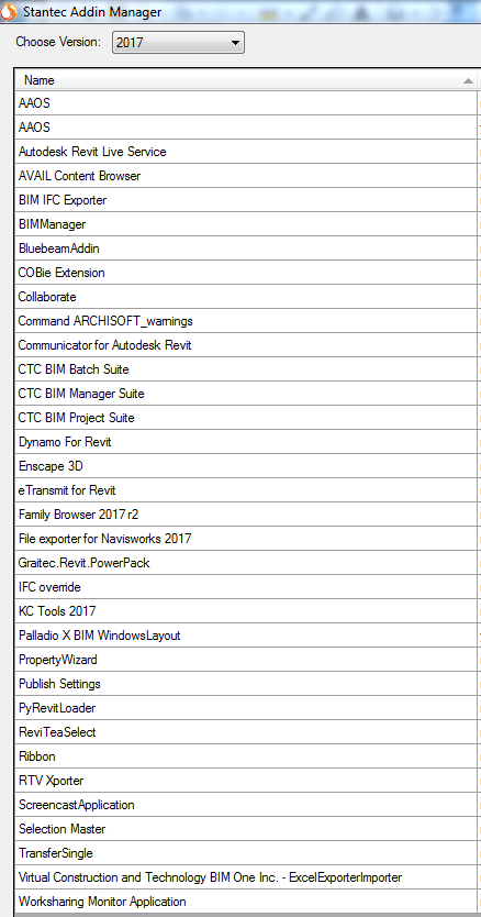

Can you post a list of all your add-ins for Revit 2017?

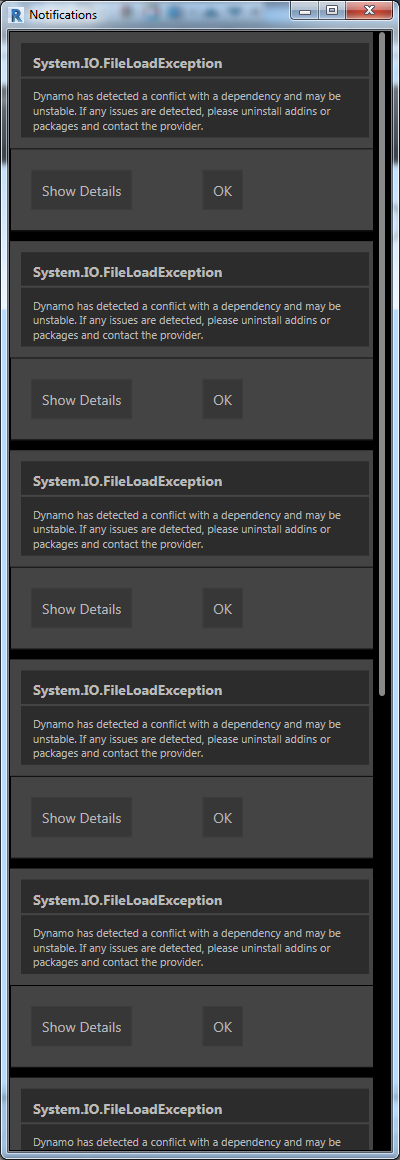

please look at the 9 notifications that you have in the dynamo menu bar and post the details here.

2017 Add Ins list
I cannot bring any of the Menus down. Neither the Notifications window
then as a first step remove pyrevit or update to the newest version - if that does not work, remove all addins/ and packages and add them back in groups until you find the culprit.
@Michael_Kirschner2, managed to get the notifications on screen. I can access them on the Home View if I have no graphs open, if this is relevant.
J
While loading assembly archilab, Version=2018.0.0.1, Culture=neutral, PublicKeyToken=null, Dynamo detected that the dependency RevitAPI, Version=18.0.0.0, Culture=neutral, PublicKeyToken=null was already loaded with an incompatiable version. It is likely that another Revit Addin has loaded this assembly, please try uninstalling other Addins, and starting Dynamo again. Dynamo may be unstable in this state.
It is likely one of the following assemblies loaded the incompatible version:
UIFrameworkInterop, UIFrameworkInterop, UIFrameworkInterop, UIFramework, UIFramework, UIFrameworkServices, AddInManagerUI, AddInManagerUI, APIInterop, RevitAPI, RevitAPI, RevitAPI, RevitAPI, RevitAPI, RevitAPI, RevitAPI, RevitAPI, RevitAPI, RevitAPI, RevitAPI, RevitAPI, RevitAPI, RevitAPI, RevitAPI, RevitAPI, RevitAPI, RevitAPI, RevitAPI, RevitAPI, RevitAPI, RevitAPI, RevitAPI, RevitAPI, RevitAPI, RevitAPI, RevitAPI, RevitAPI, RevitAPI, RevitAPI, RevitAPI, GeomUtilAPI, GeomUtilAPI, GeomUtilAPI, GeomUtilAPI, UtilityAPI, RevitDBAPI, RevitDBAPI, RevitDBAPI, RevitDBAPI, RevitDBAPI, GraphicsAPI, GraphicsAPI, FamilyDBAPI, FamilyDBAPI, FamilyDBAPI, FamilyDBAPI, FamilyDBAPI, FamilyDBAPI, EssentialsDBAPI, EssentialsDBAPI, EssentialsDBAPI, EssentialsDBAPI, EssentialsDBAPI, EssentialsDBAPI, RoomAreaPlanDBAPI, RoomAreaPlanDBAPI, RoomAreaPlanDBAPI, RoomAreaPlanDBAPI, RoomAreaPlanDBAPI, ArrayElemsDBAPI, ArrayElemsDBAPI, ArrayElemsDBAPI, ArrayElemsDBAPI, ArrayElemsDBAPI, StructuralDBAPI, StructuralDBAPI, StructuralDBAPI, StructuralDBAPI, StructuralDBAPI, StructuralDBAPI, HostObjDBAPI, HostObjDBAPI, HostObjDBAPI, HostObjDBAPI, HostObjDBAPI, HostObjDBAPI, SculptingDBAPI, SculptingDBAPI, SculptingDBAPI, SculptingDBAPI, SculptingDBAPI, ElementGroupDBAPI, ElementGroupDBAPI, ElementGroupDBAPI, ElementGroupDBAPI, CurtainGridFamilyDBAPI, CurtainGridFamilyDBAPI, CurtainGridFamilyDBAPI, CurtainGridFamilyDBAPI, SiteDBAPI, SiteDBAPI, SiteDBAPI, SiteDBAPI, SiteDBAPI, DetailDBAPI, DetailDBAPI, DetailDBAPI, DetailDBAPI, DetailDBAPI, BuildingSystemsDBAPI, BuildingSystemsDBAPI, BuildingSystemsDBAPI, BuildingSystemsDBAPI, BuildingSystemsDBAPI, BuildingSystemsDBAPI, BuildingSystemsDBAPI, EnergyAnalysisDBAPI, EnergyAnalysisDBAPI, EnergyAnalysisDBAPI, AnalysisAppsDBAPI, AnalysisAppsDBAPI, AnalysisAppsDBAPI, AnalysisAppsDBAPI, StructuralAnalysisDBAPI, StructuralAnalysisDBAPI, StructuralAnalysisDBAPI, StructuralAnalysisDBAPI, StructuralAnalysisDBAPI, StructuralAnalysisDBAPI, RebarDBAPI, RebarDBAPI, RebarDBAPI, RebarDBAPI, RebarDBAPI, AssemblyDBAPI, AssemblyDBAPI, AssemblyDBAPI, AssemblyDBAPI, APIDBAPI, APIDBAPI, APIDBAPI, APIDBAPI, APIDBAPI, APIDBAPI, DPartDBAPI, DPartDBAPI, DPartDBAPI, DPartDBAPI, StairRampDBAPI, StairRampDBAPI, StairRampDBAPI, StairRampDBAPI, StairRampDBAPI, InterfaceUtilAPI, InterfaceUtilAPI, InterfaceUtilAPI, InterfaceUtilAPI, InterfaceUtilAPI, InterfaceUtilAPI, InterfaceUtilAPI, InterfaceAPI, InterfaceAPI, PointCloudAccessAPI, PointCloudAccessAPI, NumberingDBAPI, NumberingDBAPI, NumberingDBAPI, NumberingDBAPI, MassingDBAPI, MassingDBAPI, MassingDBAPI, MassingDBAPI, RevitAPIIFC, RevitAPIIFC, RevitAPIIFC, RevitAPIIFC, RevitAPIIFC, RevitAPIIFC, RevitAPIIFC, RevitAPIIFC, RevitAPIIFC, RevitAPIIFC, RevitAPIIFC, IntfIFCAPI, IntfIFCAPI, IntfIFCAPI, IntfIFCAPI, IntfIFCAPI, IntfIFCAPI, IntfIFCAPI, IntfIFCAPI, IntfIFCAPI, AddInManager, AddInManager, AddInManager, AddInManager, AddInManager, KeynoteDBServer, StraightSegmentCalculationServers, FittingAndAccessoryCalculationServers, RvtSteelConnectionsDB, RvtSteelConnectionsDB, RvtSteelConnectionsDB, RvtSteelConnectionsDB, CollaborateDB, CollaborateDB, CollaborateDB, CollaborateDB, Revit.IFC.Export, Revit.IFC.Export, Revit.IFC.Import, Revit.IFC.Import, RSCloudClient, RSCloudClient, RSCloudClient, AddInJournaling, RevitAPIUI, RevitAPIUI, RevitAPIUI, RevitAPIUI, RevitAPIUI, RevitAPIUI, RevitAPIUI, RevitAPIUI, RevitAPIUI, RevitAPIUI, RevitAPIUI, RevitAPIUI, RevitAPIUI, RevitAPIUI, RevitAPIUI, RevitAPIUI, RevitAPIUI, RevitAPIUI, RevitAPIUI, RevitAPIUI, RevitAPIUI, RevitUIAPI, RevitUIAPI, RevitUIAPI, RevitUIAPI, RevitUIAPI, RevitUIAPI, DesktopMFCAPI, DesktopMFCAPI, DesktopMFCAPI, RevitMFCAPI, RevitMFCAPI, RevitMFCAPI, BuildingSystemsUIAPI, BuildingSystemsUIAPI, BuildingSystemsUIAPI, BuildingSystemsUIAPI, APIUIAPI, APIUIAPI, APIUIAPI, APIUIAPI, APIUIAPI, APIUIAPI, EssentialsUIAPI, EssentialsUIAPI, EssentialsUIAPI, EssentialsUIAPI, EssentialsUIAPI, EnergyAnalysisUtilitiesAPI, DetailUIAPI, RaaSApplication, RaaSApplication, RaaSApplication, RaaSApplication, RaaSApplication, RaaSApplication, RaaSApplication, RaaSApplication, AutoLoader, AutoLoader, EnergyAnalysis, EnergyAnalysis, EnergyAnalysis, EnergyAnalysis, FabricationPartBrowser, FabricationPartBrowser, FabricationPartBrowser, FabricationPartBrowser, FabricationPartBrowser, FittingAndAccessoryCalculationUIServers, FittingAndAccessoryCalculationUIServers, FittingAndAccessoryCalculationUIServers, IFCExportUI, IFCExportUI, IFCExportUI, IFCExportUI, IFCExportUI, ImportShape, ImportShape, KeynoteUIServer, KeynoteUIServer, MemberForces, MemberForces, MemberForces, MemberForces, ObjectNumberingUI, ObjectNumberingUI, ObjectNumberingUI, PointCloudSnappingServer, PointCloudSnappingServer, PressureLossReport, PressureLossReport, SectionProperties, SectionProperties, SectionProperties, SectionProperties, SectionProperties, SpaceNaming, SpaceNaming, ARCHISOFT_warnings, ARCHISOFT_warnings, Collaborate, Collaborate, Collaborate, Collaborate, Collaborate, Collaborate, Collaborate, CollaborateBrowser, CollaborateBrowser, CollaborateBrowser, CollaborateBrowser, CollaborateBrowser, SkyscraperClientHost, SkyscraperClientHost, SkyscraperClientHost, SkyscraperClientHost, C4RNET, C4RNET, C4RNET, eTransmitForRevit, eTransmitForRevit, eTransmitForRevit, WorksharingLib, WorksharingLib, WorksharingCommand, WorksharingCommand, Avail.RevitPlugin.2017, Avail.RevitPlugin.2017, Avail.RevitPlugin.UI.2017, Avail.RevitPlugin.UI.2017, Avail.RevitPlugin.Infrastructure.2017, BIMWood.BIMManager, BIMWood.BIMManager, SSONETUI, SSONETUI, SSONETUI, SSONETUI, SSONETUI, SSONET, SSONET, SSONET, BbRevitAddin2017, BbRevitAddin2017, KC Tools, KC Tools, COBieExtension2017, COBieExtension2017, COBieExtension2017, SmartMonkey, SmartMonkey, SmartMonkey, CTC.RET.BatchSuiteExternalApp2017, CTC.RET.BatchSuiteExternalApp2017, CTC.RET.SuiteStartup2017, CTC.RET.SuiteStartup2017, CTC.RET.SuiteStartup2017, CTC.RET.SuiteStartup2017, CTC.RET.AppLicensingUtils, CTC.RET.AppLicensingUtils, CTC.RET.SuiteSettingsCommon, CTC.RET.SuiteSettingsCommon, CTC.RET.SuiteSettingsDAL, CTC.Revit.SharedParametersFileTools, CTC.Revit.SharedParametersFileTools, CTC.Revit.DashboardDAL2015, CTC.Revit.FamilyUtils2015, CTC.Revit.FamilyUtils2015, CTC.Revit.FileOpener2015, CTC.Revit.TypeCatalogDAL2015, CTC.Revit.UserControls2015, CTC.Revit.DashboardDAL2016, CTC.Revit.FamilyUtils2016, CTC.Revit.FamilyUtils2016, CTC.Revit.FileOpener2016, CTC.Revit.TypeCatalogDAL2016, CTC.Revit.UserControls2016, CTC.Revit.DashboardBLL2017, CTC.Revit.DashboardDAL2017, CTC.Revit.DashboardDAL2017, CTC.Revit.ExtensibleStorageTools2017, CTC.Revit.FamilyGeometry2017, CTC.Revit.FamilyUtils2017, CTC.Revit.FamilyUtils2017, CTC.Revit.FamilyUtils2017, CTC.Revit.FileOpener2017, CTC.Revit.FileOpener2017, CTC.Revit.FileOpener2017, CTC.Revit.PrintingTools2017, CTC.Revit.ProjectUtils2017, CTC.Revit.TaskDialogTools2017, CTC.Revit.TaskDialogTools2017, CTC.Revit.TypeCatalogDAL2017, CTC.Revit.TypeCatalogDAL2017, CTC.Revit.UserControls2017, CTC.Revit.UserControls2017, CTC.Revit.DashboardDAL2018, CTC.Revit.FamilyUtils2018, CTC.Revit.FamilyUtils2018, CTC.Revit.FileOpener2018, CTC.Revit.TypeCatalogDAL2018, CTC.Revit.UserControls2018, CTC.Util.ScheduledTaskTools, CTC.RET.PlotterAndExporter2017, CTC.RET.PlotterAndExporter2017, CTC.RET.PlotterAndExporter2017, CTC.RET.PlotterAndExporter2017, CTC.RET.PlotterAndExporter2017, CTC.RET.ManagerSuiteExternalApp2017, CTC.RET.ManagerSuiteExternalApp2017, CTC.RET.ProjectCleaner2017, CTC.RET.ProjectCleaner2017, CTC.RET.DimensionChecker2017, CTC.RET.DimensionChecker2017, CTC.RET.DimensionChecker2017, CTC.RET.DimensionChecker2017, CTC.RET.FamilyChecker2017, CTC.RET.FamilyChecker2017, CTC.RET.FamilyChecker2017, CTC.RET.FamilyChecker2017, CTC.RET.FamilyChecker2017, CTC.RET.FamilyChecker2017, CTC.RET.ProjectSuiteExternalApp2017, CTC.RET.ProjectSuiteExternalApp2017, CTC.RET.BIMList2017, CTC.RET.BIMList2017, CTC.RET.BIMList2017, CTC.RET.BIMList2017, CTC.RET.BIMList2017, CTC.RET.BIMList2017, CTC.RET.LengthCalculator2017, CTC.RET.LengthCalculator2017, CTC.RET.LengthCalculator2017, CTC.RET.LengthCalculator2017, CTC.RET.ProjectLink2017, CTC.RET.ProjectLink2017, CTC.RET.ProjectLink2017, CTC.RET.ProjectLink2017, CTC.RET.ProjectLink2017, CTC.RET.Renumbering2017, CTC.RET.Renumbering2017, CTC.RET.Renumbering2017, CTC.RET.Renumbering2017, CTC.RET.FabSheets2017, CTC.RET.FabSheets2017, CTC.RET.FabSheets2017, CTC.RET.FabSheets2017, CTC.RET.FireRating2017, CTC.RET.FireRating2017, CTC.RET.FireRating2017, CTC.RET.FireRating2017, CTC.RET.ModelCompare2017, CTC.RET.ModelCompare2017, CTC.RET.ModelCompare2017, CTC.RET.ModelCompare2017, CTC.RET.ModelCompare2017, CTC.RET.ParameterJammer2017, CTC.RET.ParameterJammer2017, CTC.RET.ParameterJammer2017, CTC.RET.ParameterJammer2017, CTC.RET.ParameterJammer2017, CTC.RET.RoomDataSheets2017, CTC.RET.RoomDataSheets2017, CTC.RET.RoomDataSheets2017, CTC.RET.RoomDataSheets2017, CTC.RET.RoomFamilyManager2017, CTC.RET.RoomFamilyManager2017, CTC.RET.RoomFamilyManager2017, CTC.RET.RoomFamilyManager2017, CTC.RET.ScheduleXL2017, CTC.RET.ScheduleXL2017, CTC.RET.ScheduleXL2017, CTC.RET.ScheduleXL2017, CTC.RET.ViewCreator2017, CTC.RET.ViewCreator2017, CTC.RET.ViewCreator2017, CTC.RET.ViewCreator2017, DynamoRevitVersionSelector, DynamoRevitVersionSelector, ExcelExporterImporter, ExcelExporterImporter, ExportViewSelectorAddin, ExportViewSelectorAddin, Graitec.Revit.PowerPack.2017, Graitec.Revit.PowerPack.2017, Graitec.Revit.PowerPack.2017, Graitec.Revit.PowerPack.2017, Graitec.Revit.2017, Graitec.Revit.2017, Graitec.Revit.BIMConnect.2017, Graitec.Revit.BIMConnect.2017, IFCExportUIOverride, IFCExportUIOverride, IFCExportUIOverride, IFCExportUIOverride, Revit.IFC.Common, Revit.IFC.Common, Revit2017, nwexportrevit2017_14, nwexportrevit2017_14, PropertyWizard, PropertyWizard, ReviTea, ReviTea, RTV_LoadXporter, RTV_LoadXporter, SelectionMaster2017, SelectionMaster2017, AddInJournalClient, TransferSingle, TransferSingle, RevitAPIUIMacrosInterop, RevitAPIUIMacrosInterop, RevitAPIMacrosInterop, RevitAPIMacrosInterop, RevitAPIMacrosInterop, RSEnterpriseClientInterop, RSEnterpriseClientInterop, RSEnterpriseClientInterop, RSEnterpriseClientInterop, RSEnterpriseClientInterop, RSEnterpriseClientInterop, RSEnterpriseClient, RSEnterpriseClient, RSEnterpriseClient, RSEnterpriseClient, RSEnterpriseClient, RSEnterpriseClient, RevitAPIBrowserUtils, RevitAPIBrowserUtils, RevitAPIBrowserUtils, RevitAPIBrowserUtils, RevitAPIBrowserUtils, RevitAPIBrowserUtils, RevitAPIBrowserUtils, RevitAPIBrowserUtils, RebarUIStartUpAPI, RebarUIStartUpAPI, RebarUIStartUpAPI, DynamoRevitDS, DynamoRevitDS, RevitServices, RevitServices, DynamoRevitAdditions, DynamoRevitAdditions, DynamoRaaSHelper, RevitNodes, RevitNodes, SimpleRaaS, SimpleRaaS, RevitRaaS, RevitRaaS, RevitRaaS, RevitRaaS, RevitRaaS, RevitRaaS, RevitRaaS, DSRevitNodesUI, DSRevitNodesUI, DynamoRaaS
@Michael_Kirschner2, managed to get it to work when disabling the AVAIL Content Browser add in.
