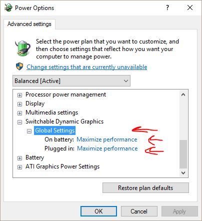

-Go to power options…change plane settings…change advanced power settings…switchable dynamic graphics… and then set - on battery and pluged in (maximize performance).

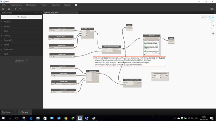

Hey, guys!
I had the same issue with background preview.
I tried lots of different solutions, but they did not work. Finally I tried to switch off one of the graphics adapters, and after this I see this error on the background. I switched on both graphics adapters, but nothing changed.
I have Windows 10 Pro, Revit 2017 and Dynamo 1.3.0.875.
Graphics adapters are ‘AMD Radeon 6600M and 6700M Series’ and ‘Intel® HD Graphics 3000’.
My graphics settings are on the high performance.
Do you know any solution for this problem? Please, help.
Well, I solved this issue by switching off one of the graphics adapters, then I switched it on again and restarted my laptop.
But the preview still does not work.

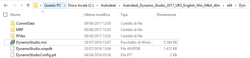

Another thing that i noticed is that sometimes the Microsoft .NET Framework old versions are not automatically installed in the SO and to me that cause many problems during installation of softwares, this is a reason why i usually install the .msi version of setup instead of .exe.
Actually i usually reinstall SO then i update the SO to latest version available, then i install all version of .NET Framework from v.2 to latest, then, i install all autodesk softwares. Because sometimes with the .exe package installations something goes wrong, i prefer to use the .msi
Here my Dynamo specifications for Revit, i am using Revit 2018
Here where you can download latest build http://dynamobuilds.com/
