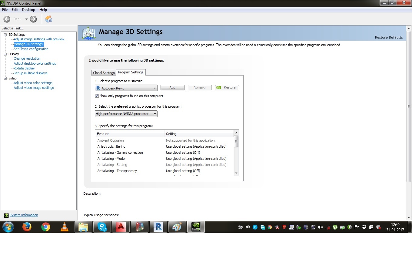

I have Dell Inspiron r15, with i5-2410m 4gb ram
Above are the configuration of laptop and Nvidia setting, in sandbox I can see 3d background while in Revit I cannot see that.
Please tell me step by step as I am not tech savvy.
Appreciate your help
Hi Sunil,
Kindly change the ‘preferred graphics processor’ to Intel/Default Graphics and try starting Revit. I suggest to do this as it resolved the issue in my work laptop.
Revit doesn’t rely much upon the high-end graphic processor for Visuals compared to Rhinoceros which uses GPU acceleration for display.
Regards
Thanks it worked
