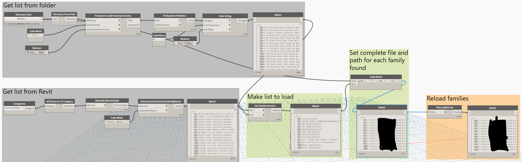

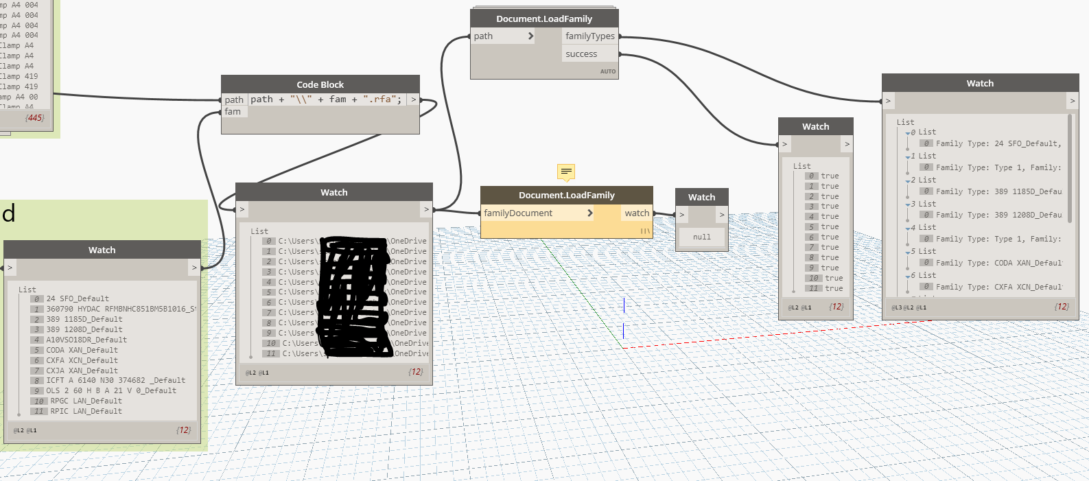

As you can see the Clockworks node works (but it doesn’t overwrite already loaded families) but, the Orchid one doesn’t with the same input. It give this error “Warning: Document.LoadFamily expects argument type(s) (Document), but was called with (string).”
What I want to do is reload existing families with modified families I saved to a folder. (These are simplified versions of the same families) Compare families currently loaded in file with families in folder.
A New list of found families is created to load from folder location overwriting those already in the file. the file is a nested main family.
